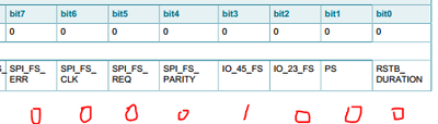

When the 1st power on, MCU read below registers' values,
FS45_FS_INIT_FSSM_ADDR [0x25]  = 0x08
FS45_M_DIAG_VPRE_ADDR [0x0C] = 0x40
FS45_M_DIAG_VCORE_ADDR [0x0D] = 0x00
FS45_M_DIAG_VCCA_ADDR [0x0E] =0x00
FS45_M_DIAG_VAUX_ADDR [0x0F] = 0x00
FS45_M_DIAG_VSUP_VCAN_ADDR [0x10] = 0x00
FS45_M_DIAG_SPI_ADDR [0x13] = 0x00
FS45_FS_DIAG_SF_IOS_ADDR [0x2D] = 0x00
And I find more symptoms of this issue,
1. While IO_2 = 5V, let SBC enter low power mode (sleep), then wake up by IO_0, this issue will happen too.
2. When this issue happens (SBC doesn't release RSTB), remove IO_2, then SBC will release RSTB.
Snaku
