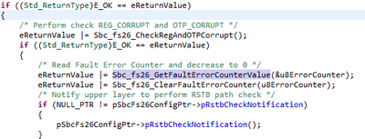

when i initialized FS26 with S32K311,
watchdog period = 32ms, watchdog duty cycle = 37.5%OPEN, watchdog recovery = 64ms,
but in " Decrease FLT_ERR_CNT to 0 with WD_ERR_LIMIT good WD refresh",
I got u8ErrorCounter = 1 in below codes.
I don't know the meaning about "with WD_ERR_LIMIT good WD refresh", is that means it need to plus a WDrefresh routine code?
Hope your answer!
Kate

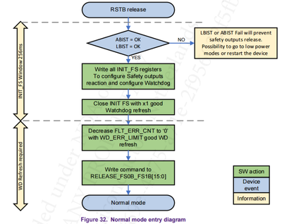

Finally you must use the normal mode not the debug mode,you can refer to below  for feed WD:
12 返答(返信)
8,121件の閲覧回数
guoweisun
For your question:
1: Is that means it need to plus a WDrefresh routine code?
[gw]Correct,you need continue to refresh WD till the fault error counter decrease into 0.

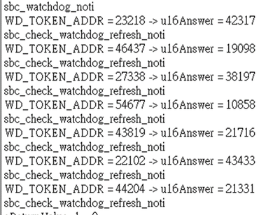

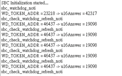

kate___
Hi guoweisun,
If I was in Debug mode, I can have a good WDfresh like below.
Then I can get SBC initialize OK.
But in Normal mode, I got a bad WDfresh like below.
Then I can't initialize SBC.
What states I need to set ?

guoweisun
