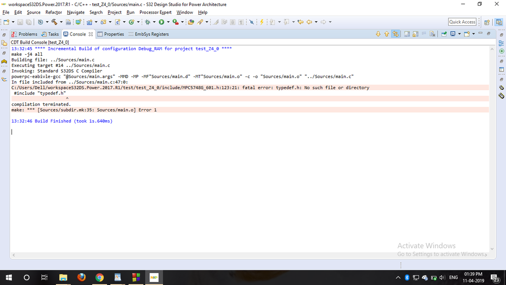

amogh_negalur
thank you sir,
   I had not included the MPC5748G.h. Now, i tried including the "MPC5748G_601.h" and got the following error.ss.png
The following is the link to my project. Please help me out
https://drive.google.com/open?id=1guM3leN250VZ1JQdNcA73S2MXW98ZNRv
3,699件の閲覧回数
martin_kovar
I did not know you use SDK based project. Unfortunately, this project use different header file and it is not recommended to use your own header file. Please delete your header file and please use following way, how to access registers:
/*Set SRC = 3, OBE = 1 and SSS = 1 */
 SIUL2->MSCR[37] = 0x32000001;
or you can use included macros. The same result as the code above:
 SIUL2->MSCR[37] = SIUL2_MSCR_SSS(1)| SIUL2_MSCR_OBE(1) | SIUL2_MSCR_SRC(3);
Martin
