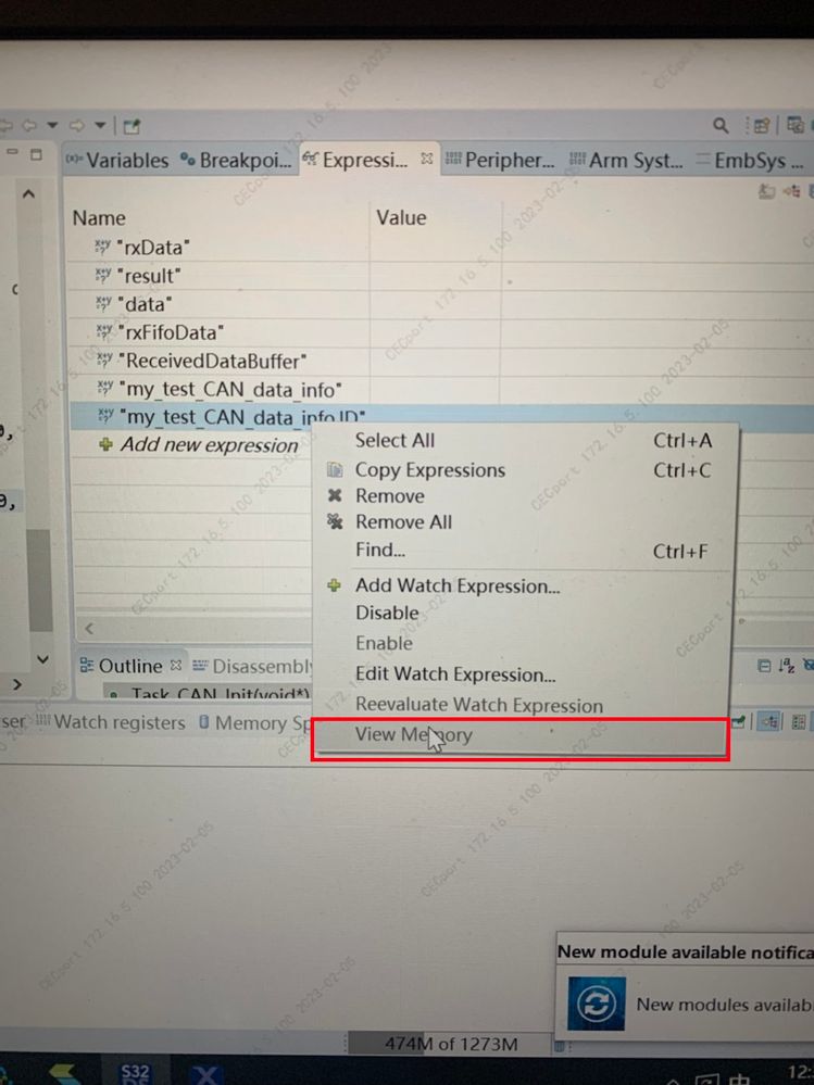

Does MCUXPresso IDE has expressions can show view memory like S32DS?
已解决
跳至解决方案
1,331 次查看
jingfang
S32DS:

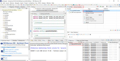

Hi jingfang
We can view memory in global variables window. See below
