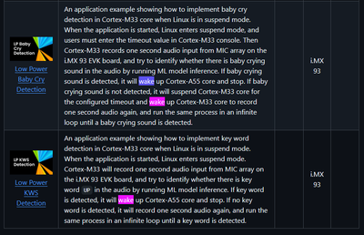

Tried running the gopoint voice control applicaton wakeword_demo  in imx8mplus flashed with linuxBSP the gui is stuck after launching. This is the case for all the applications, but running the face recognition application without gui works fine. So how can I run the voicecontrol application  which wakes the board with "Hey NXP" without gui. where can I get the model files for the same. If ready script is not available as I could see the model files are hardcoded with the gui app.

That example is running in our IMX93-EVK board but no in iMX8MP-EVK board due to the IMX8MP-EVK board does not have microphones.

So I have Imx8MPlus board flashed with Linux BSP 6.6.52. I am Unable to run any of the (not just audio related) Gopoint applications as the GUI is stuck after launching app. Also my requirement was to execute a wake word detection in the board by using the microphone of connected headset which is able to record audio. So are these go point applications exclusively for IMX93? Also will moving to IMX93 makes it possible to use wake word detector demo?

This demo is working in the iMX93-EVK ate the moment:
