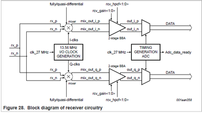

Currently ı have a design which ı am using #MFRC522. Right now ı am updating this design for #CLRC663 plus. I have question about that:
Why there are two Tx pin İn both IC?
Why #MFRC522 has one Rx pin and#CLRC663 has two?

Hello @muratt
This is determined by the internal structure of the IC. CLRC663 adds a mixer to optimize the RX performance, is backward compatible with MFRC522, and has various performance improvements.
