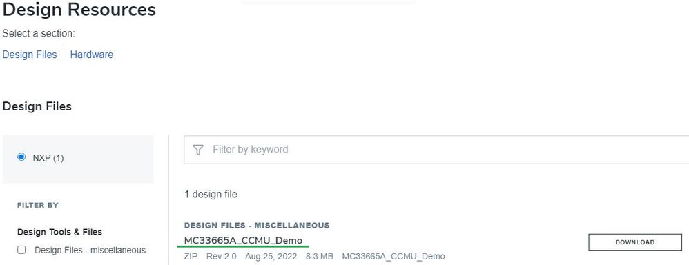

Hi Erik,
DBC and CAN files are available in MC33665A_CCMU­_Demo. There is the User Manual available to work with the demo.
MC33665A_CCMU­_Demo:
https://www.nxp.com/products/power-management/battery-management/battery-communication-ics/general-p...
Tomas
