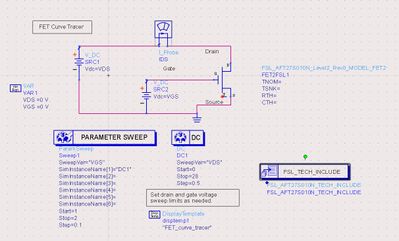

I am doing some basic simulation of AFT27S010N transistor in ADS and I have some questions.
First, I am simulating IV curves.  This is the schematic:

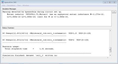

With this schematic, after launching simulation, I get the following warning:
Is there something wrong in my schematic? How can I avoid such warning?
Ignoring this warning, I go on with simulation.  IV curves seem to be ok.  For Vdc = 28v and Vgs = 1.9v, I get Ids = 112mA, which is near the 90mA used along the datasheet.

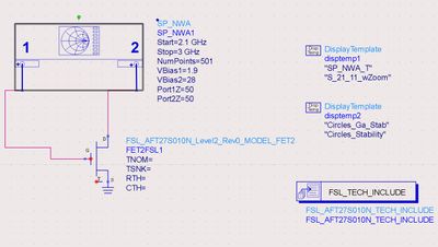

After that, I use another schematic to get S(2,1).  In this schematic I set Vds = 28v and Vgs = 1.9v.

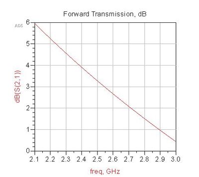

The values for S(2,1) are just a few dB, far from the about 20 dB stated in the datasheet.
Is there something wrong with the setup of my simulation?
