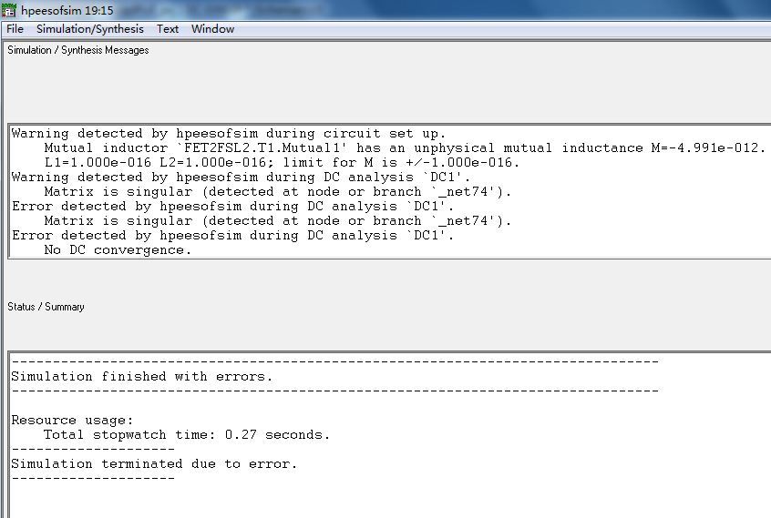

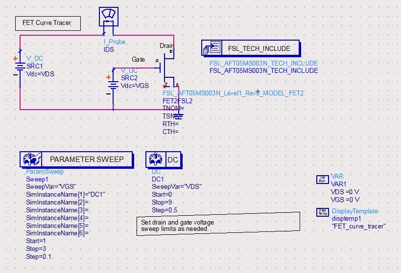

AFT05MS003N ADS2009 simulation have errors,why?

I fear that the issue is ADS2009. Our models that can be downloaded from our web site are running either under ADS 2011 and newer.
General suggestion is to upgrade ADS to a newer revision. No problems with ADS2016.01.
