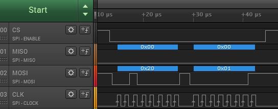

* The PCF2129AT is a CMOS Real Time Clock (RTC) and calendar with an integrated
* Temperature Compensated Crystal Oscillator and a 32.768 kHz quartz crystal
* optimized for very high accuracy and very low power consumption.
* This simple example code has been written for the FRDM-KL25Z + OM13513
* boards and demonstrates how to set and read the time/date on the PCF2129AT
* using the SPI (do not forget to remove the JP1 jumper) interface. It also
* illustrates how to use a second interrupt to generate an interrupt on the
* INT pin once per second when the Seconds register increments.
* In this example the time to be set is Wednesday, February 26 2020, 10:30 AM.
* Connection:      FRDM-KL25Z           OM13513
* VDD                 J9-4                           P2-2
* GND                 J9-14                         P2-1
* MOSI               J2-8                            P2-5
* MISO               J2-10                          P2-6
* SCLK               J2-12                          P2-4
* CS                   J2-6                            P2-7
* INT                  J1-6                            P2-8
Enabling the second interrupt by writing 0x01 to the Control_1 register (0x00):
Second interrupt generated on the INT pin once per second:

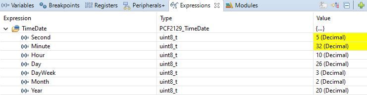

Setting the time and date by writing to registers Seconds (0x03) - Years (0x09):
Actual time and date shown in the Debug window:
