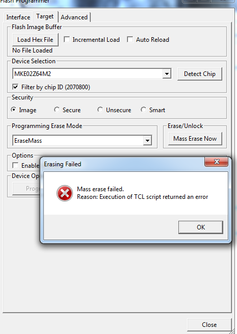

lucianonicolau
Hi pgo,
The KV44 works perfectly with KDS and ARM Programmer!
Check the MKE02Z64, it is not working with 4.12.1.160  it can detect chip but cannot erase and program, see the error:
I reinstall all with no success for MKE02.
Luciano

pgo
Senior Contributor V
Hi Luciano,
As Raimond has indicated, I have broken the ME support in the .160 version.
Yo can see this thread https://community.nxp.com/thread/446167?sr=stream
for a quick fix (replacement MKE02 script attached near the bottom)
bye
