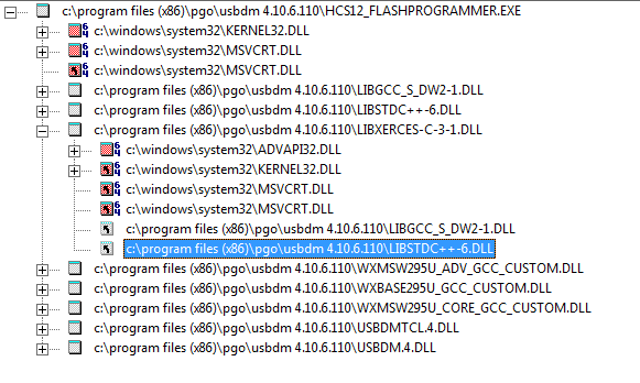

If you wish to check further you can use a program like Dependency Walker (depends.exe) Home Page to check where the program is loading DLLs from to look for anything out of the ordinary,  On my (WIndows 7) machine it produces the following:
