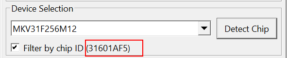

Hi ,
I am facing issue to flash Kinetis KV10 using USBDM interface.
I have KV10Z128M7 and When I am trying to detect USBDM is detecting KV10Z16M7 but not able to program it.
Seems, There is no support of KV10Z128M7 mcu or may be some other issue.
Can any help me out how Can I ,program this mcu using USBDM.
Sunil

Hi Sunil,
The KV10Z128M7 has not been tested and is not currently supported.
I have added the required entries to the attached file.
You can try using this file if you wish.  You would need to replace the existing file in C:\Program Files (x86)\pgo\USBDM 4.12.1.40\DeviceData
I'm not sure of SDID (part ID) - If you could confirm this (it appears on the Programmer dialogue as shown) after Detecting the chip.
bye
