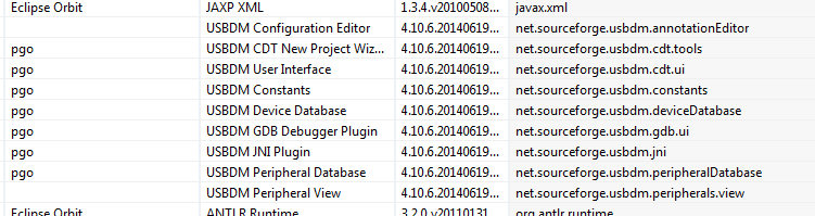

Hi Ian,
This looks like it can't find one of the plugins - probably because it failed to load or was the wrong version.
Can I find check the following:
  • What version of USBDM is installed?
  • When exactly is this error occurring?  During the creation of the Debug Launch configuration?
Also please check the following:
  • Make sure there are not any bits left over from other versions of USBDM.  For example if your installed an earlier version that didn't have the KDS installation and and manually copied the plugin files into the ...\Freescale\KDS_1.0.1\eclipse\dropins directory it will be necessary to delete these.  Later installers don't have this problem.

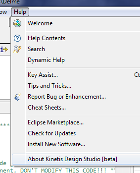

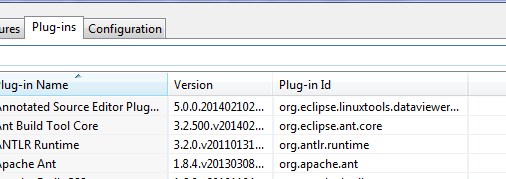

  • Can you check the USBDM plugin versions installed in KDS.  This can be done by
    • Selecting : Help->About Kinetis Design Studio
    • Then Installation Details button
    • Select Plug-ins tab
    • Click on the Plug-in Id column header to sort the column.
    • The list should be similar to that shown below.

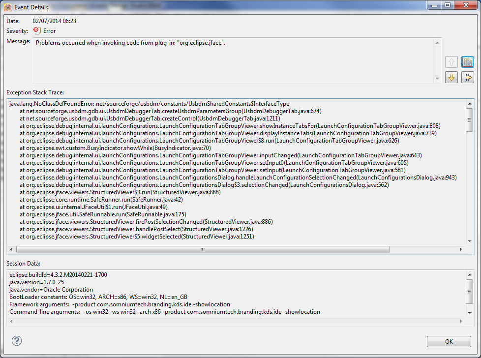

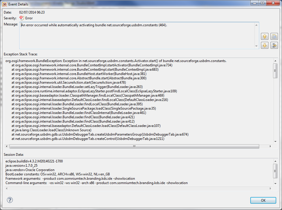

ebee
Hi pgo,
Sorry about the confusion. The plug is is not working within KDS where ever I plug the BDM in.
I have followed the instructions that you gave. On restarting KDS there was not any messages relating to USBDM in the log. When I try to connect to the debugger two new errors occur -
Problems occurred when invoking code from plug-in: "org.eclipse.jface". in plug in org.eclise.jface.
An error occurred while automatically activating bundle net.sourceforge.usbdm.contstants (464) in plugin org.eclispe.osgi
I have attached the full (or as much as I can get) error reportserror2.pngerror1.png

pgo
Senior Contributor V
Hi Ian,
The second exception looks more hopeful for a clue.
It appears that one of the plugins is throwing an exception when loading.  Probably processing the USBDM paths but there isn't enough information to be sure.
I should have asked you to post the .metadata\.log file from the workspace you are using as this contains the entire log.
Would you please repeat clearing the log and triggering the exceptions?
Clearing the log first will reduce the "clutter" in the .log file.

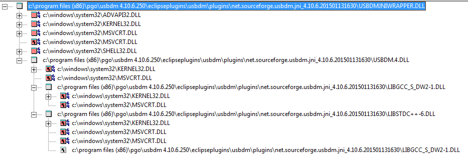

pgo
Hi Richard,
Thanks for the quick feedback!
I did use a dependency checker on the original and larger DLL and they both appear to have the same dependency tree below.
Anyway it must be some subtle problem (or at least too subtle for me!).  I have been caught before with the system picking up a DLL from somewhere else on my machine and hiding a problem like this so I suspect it is something like this.
Thanks again for taking the time to troubleshoot this.
I will upload an updated build tonight and I hope it will solve this.
