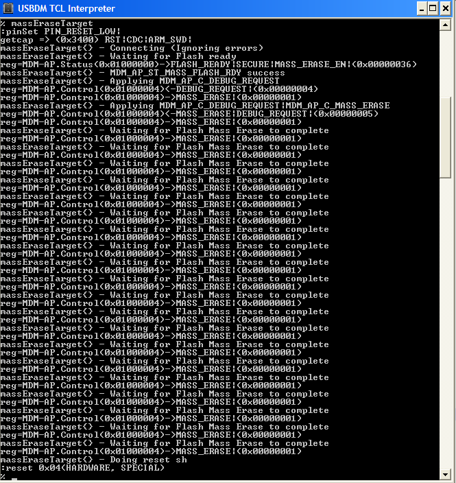

When programming-->> unable to read/confirm CHIP_ID,
When trying to Detect the CHIP_ID->> Device appears to be secured.... Unsecure and enterely erase?
When unsecuring-->>Failed to probe the target reason Target is secured

I have tried to use the TCL interpreter to found a solution, when i source the following script
openbdm
settarget arm
source devicedata/arm/Kinetis-KLxx-flash-scripts.tcl
catch { connect }
rcreg  $::MDM_AP_Status
I get the following:
So it seems it is secured??? But it can be mass  erased...
When I try the massEraseTarget  I get:
.....so no luck.

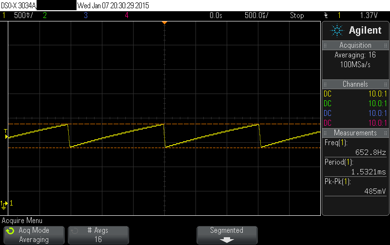

The RESET behaviour was also the same (oscillating ~485mVp-p at 1.6ms period.
For reference the waveform for a blank device:
pastedImage_0.pngbye

It would appear that a new chip is blank apart from the security value of 0xFE which makes it unsecured so AFAICS it would operate the same as a mass-erased chip.

  4. Tried the OpenSDAMassEraseKinetis.sx Fw the USBDM (connecting and reconnecting power). Supossed to mass erase successfully but no succees.

Just to know, the fresh device gave me the following status,----> not secured.
The RESET behaviour was similar oscillating ~500mVp-p at 1.33ms period.
