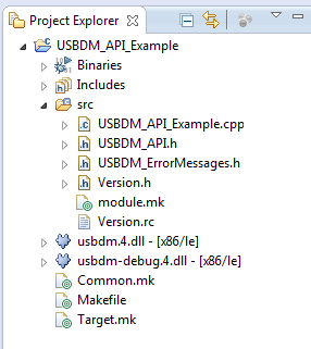

Hi Padelis,
I usually do work using Eclipse with MinGW.  The following screen grab shows the required files to build the example application:
This project is included in the USBDM installation and is available in Eclipse if installed.
You can get these files from the directory (path will vary):
C:\Program Files (x86)\pgo\USBDM 4.10.6.120\Examples\USBDM_API_Example.zip
Since you are using Codeblocks you need to add the cpp file to your 'project' and make sure the header files are available (in the same directory?).  The dlls will need to be added as well.  I have no idea how to do this with Codeblocks.
Alternatively, since you have MinGW installed you can just unzip the above file and then open a command line in the directory and build the example by typing (path will vary):
c:\Apps\MinGW\bin\mingw32-make.exe
