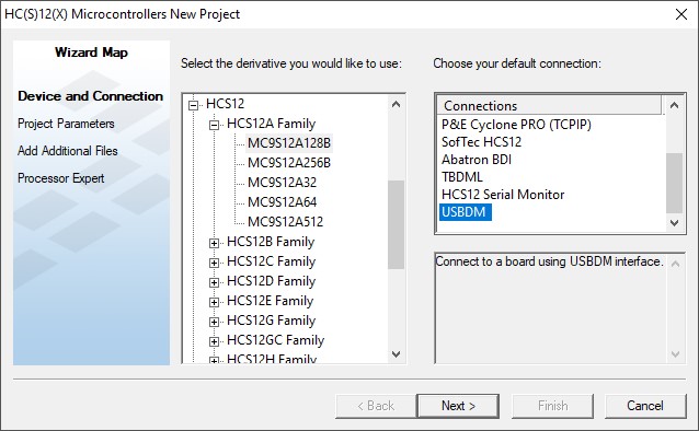

I am attempting to program an old board with this chip on it but am completely new to this microcontroller family and so would appreciate some advice.
I have downloaded and installed the USBDM_4_12_1_340_Win.msi Windows software and was able run the "USBDM Memory Dump" application and dump the flash memory (address range 0x8000-0xFFFF) on the 68HC912B32 chip.
I also looked at the "HCS12 Programmer" or "Flash programmer" application but it does not have the MC912B32 chip on its pull-down menu list. I also tried "Device selection" with the "Detect Chip" button but it was unable to detect my chip.
I don't need a full development environment / IDE, just the ability to dump the flash memory, replace the damaged microcontroller and program the new one with the dumped program.
This 4 year old https://community.nxp.com/t5/OSBDM-and-TBDML/program-the-HC12-B-Family-of-MCU/td-p/1324102 thread is interesting but does not provide a solution.  Noting the contributions further down that thread by @pgo regarding Tcl/Tk, my preferred OS is Linux rather than Windows so am more than happy to try a Linux based solution.
Any thoughts on how I might get a working programming environment set up?
Many thanks
Tom Crane

Hi @pgo,
Thanks for the follow-up. I had some progress.  The solution to the non-appearance of support for the 68HC912B32 in Code Warrior 5.2 was to install Code Warrior 5.1 instead. This is suggested here https://community.nxp.com/t5/CodeWarrior-for-MCU/CodeWarrior-Development-Studio-for-HCS12-X-Microcon....
Under 5.1 (see attached screen-grab Code-warrior2-run-as-administrator-MC68HC912B32+USBDM.jpg) the MC68HC912B32 chip is now present and can be selected.  However there is no USBDM or TBDML option listed in the Connections pull-down menu.  I had reinstalled USBDM and its drivers after reinstalling Code Warrior 5.1 and had plugged the USBDM into the PC.
To check if the non-appearance of the USBDM in the Code Warrior Connections menu was due to the 68HC912B32 not being supported by the USBDM, I tried selecting another chip that is supported by USBDM.  I chose a MC9S12A128B.  Now the Connections menu sports 3 additional entries; "TBDML", "HCS Serial monitor" & "USBDM".  See attached screen-grab Code-warrior2-MC68HC9S12A128B+USBDM.jpg.
Apart from trying to modify the USBDM Tcl code to support the 68HC912B32, are there any other S/W applications or other options which could be used with the USBDM pod to program this chip?
If not, are there any other H/W options with S/W support that would let me program the flash memory in a 68HC912B32 ?  The board I have has only the 6-pin BDM socket for debugging/programming -- so have to assume that is how the manufacturer originally programmed it, unless it was done out-of-circuit before soldering in, which seems unlikely...
Tom.

tomcrane
Hi Pgo,
Thanks for the follow-up.  I have partially disassembled the image I dumped earlier so should be able to cobble together a .asm file to go in a Code Warrior project.
I could not find a version 6 of Codewarrior to download but did download from this https://www.nxp.com/design/design-center/software/development-software/codewarrior-development-tools... link.  It is listed there as version 5.2 and importantly under the "Expand All" checkbox at "Supported Devices" the 68HC912B32 is listed.
Installing + running the application and checking the version number shows 5.9 rather than 5.2. See attached screen-grab image.
Invoking "Startup dialog..." and "Create new project" provides a pop-up with the choice of chip families.  See the attached screen-grab image.  It lists only HCS12 & HCS12X families.
Expanding those shows the family members. See the attached screen-grab image. As expected there is no HCS912B32 amongst them.
Am I doing something wrong or missing something obvious?
Many thanks
Tom Crane
