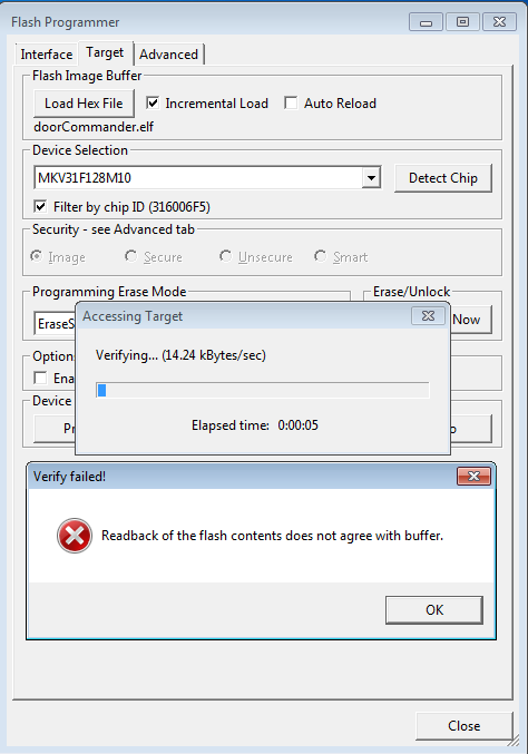

Hello All,
I am trying to program my custom board with kl25z-freedom.
Custom board has MKV31F128VLH10.
i did install USBDM and its drivers. After that i uploaded the usbdm sda firmware to kl25z.
to prevent unwanted interference i uploaded BootLoopMKL.elf file to on board mcu of kl25z.
everything was perfect. then i cut the jumper J11 on kl25z and made connections between kl25z and my sutom board.
i connected swdio, swclk and gnd and jtag_reset.
After connections are made i did power my board up and in arm programmer i clicked on detect device. flawlessly, probe detected the
MKV31F128VLH10. to make sure i did mass erase the device. erasing was successful.
But when it comes to programming flash, it fails like that in the picture
But its confusing that verify flash seems working

Hi Alican,
I have found an error in the device description used by USBDM for the  MKV31F128M10 but I am unsure if it would account for the errors you are seeing.
Could you use replace the file "C:\Program Files (x86)\pgo\USBDM ....\DeviceData\arm_devices.xml" with the attached file and see if it makes any difference?
You will probably need to select the EraseMass option,

alicankurutepe
Hello pgo
Thank you for your efforts.
At least it seems working after replacing the xml file.
i did a few trials but it did not fail proframming with mass erase before programming.
