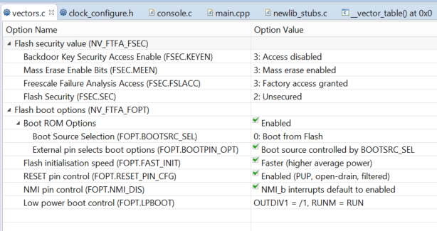

I have installed USBDM_4_12_1_80_Win_A.msi ​​which I want to use to debug a MKL27Z256M4 via a Freedom MKL25 board.
I start up the GDB server then in GDB enter the following:
target remote :1234
b main
continue
which results in:
Program received signal SIGINT, Interrupt.
0x1c0000C0 in ?? ()
0x1c0000c0 would be someplace in the bootloader.
Is there something I need to turn off to get the bootloader out of the way?
Where is this 'SIGINT' coming from?

I added the mon reset otherwise the program would already be running and the break-point would not occur.
I have attached the project and .elf file used.
The code does set up the bootloader options but I can't remember off-hand what the various options mean.  Have a look in the vectors.c file.
If you are using KDS you can change the options using the configuration editor.

Thank you, that got me further down the path.
The difference between your working version and mine was in the setting of the FOPT byte in the flash configuration section 0x400->0x040F.
I get further, alas before I reach main() I get 'connection lost'.  Ideas?
Off to tediously single step till find the point causing the disconnection...
