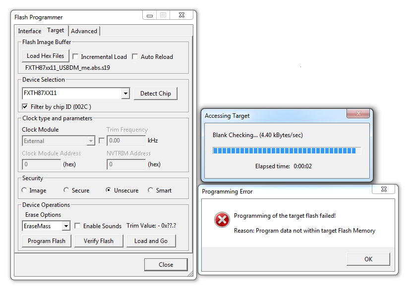

Hi all,
I tried to use USBDM to program the FXTH87xx . But in the list of chips in Flash Programmer this MCU is absent. So, I insert this in the hcs08_devices.xml:
     <!ENTITY HCS08-alt-load-flash SYSTEM "HCS08/FXTH87xx11_Starter_Project_CW10.abs.s19">
     <flashProgram id="HCS08-alt-load-flash">
          &HCS08-alt-load-flash;
     </flashProgram>
     <device family="HCS08" name="FXTH87xx11">
          <memory type="ram">
               <memoryRange start="0x000090" end="0x00028F" />
          </memory>
          <memory registerAddress="0x1820" type="flash" securityAddress="0xFFB0">
               <securityEntryRef ref="HCS08-fnored-security"/>
               <memoryRange start="0x00C000" end="0x00DFBF" />
          </memory>
          <sdid value="0x002C" />
          <flashProgramRef ref="HCS08-alt-load-flash" />
     </device>
I'm not sure thay I use right values especially securityEntryRef section. But now flash Programmer detect my chip. But when I click Program Flash, on EraseMass status pop up error:
Hope someone can help me.

Hi Sunrme,
Could you change the end address in the XML file to 0xDFFF as it appears that there is a pseudo-vector table to be programmed as well.  Also remove the references to security - in other words use the following:
  <device family="HCS08" name="FXTH87xx11-Partial-Erase">
     <memory type="ram">
        <memoryRange start="0x000090" end="0x28F" />
     </memory>
        <memory registerAddress="0x1820" type="flash">
           <memoryRange start="0x00C000" end="0xDFFF" />
     </memory>
     <flashProgramRef ref="HCS08-alt-load-flash-program" />
     <note>Untested</note>
  </device>
Make sure you select EraseSelective when programming.
bye

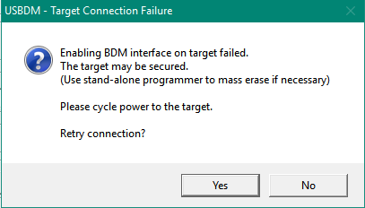

I had another issue regarding programming of FXth8705D, The problem was that everytime I try to detect or Program the ic, It always throws some error like this,
Now, After Scratching my head all day started reading datasheet more carefully, and Then I came to this section of the datasheet.
In very first bullet it says, In order to enter into BDM, BKGD should hold down while powering up the FXTH87xx. and My Programmer doesn't have the software control over powering up the target.
What was I doing Wrong?
I inserted all four connector RST, GND, VCC, BKGD, simultaneously which somehow doesn't let FXTH87xx entering into BD mode. What I did was, I connected RST, GND, BKGD first then after that VCC. Which Ensured the First point in the bullet, in above image. and Voila.............I Succeed.
Hope It will help someone, and might save his day.
Thanks and Regards
Sumir Kumar Jha, India

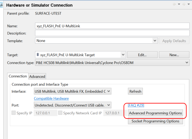

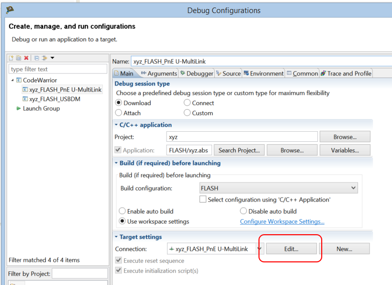

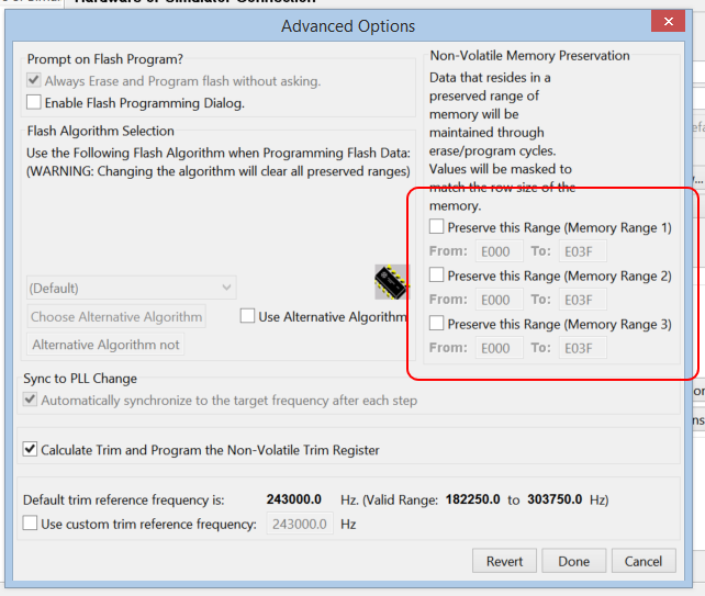

pgo
Senior Contributor V
Hi Razvan,
I don't actually use a multi-link so the following may be incorrect:
Open the launch configuration and select Edit under target connection:
Select Advanced Programming Options:
You can then protect ranges:
bye

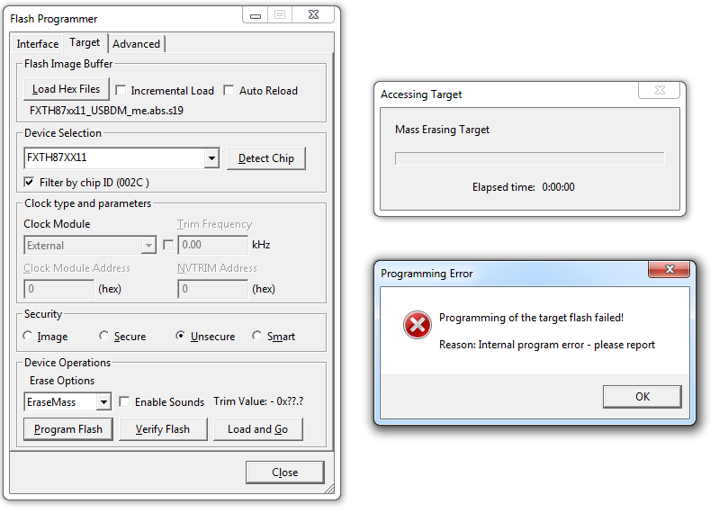

Hi pgo,
I updated firmware to Ver 4.10.6 and USBDM to 4.10.6.230. I added your configuration, but changed ssid from 0x0000 to 0x00C2, because after click detect chip, chip is not determined by the USBDM FLASH PROGRAMMER. And get the same issue, logs attached.
13,599 Views

Hi pgo,
I changed "size" to "end" and got this:
13,599 Views

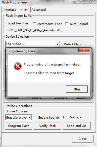

sunrme
Hi pgo,
Thank you for your help, USBDM flashed FXTH87 finally. I changed hcs08_devices.xml, but don't change EraseMass to EraseSelective, because when selected EraseSelective, I got fail (I added logs).
And it relly be cool if I can to debug in codeWarrior this chip. And when I try to do this I got issue:
Error launching fxth87_empty FLASH
Bad arguments passed to function
If you will help me with this, I will be grateful. But I don't know where get logs, only what generated CW (attached)
