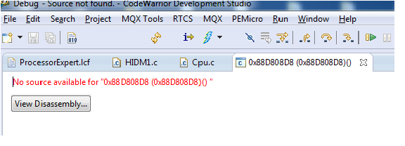

I'm working with CodeWarrior 10.6 and MCF51MM256 (Coldfire V1). I was working with USB BDM Multilink debug interface for few months and everything was ok. Now I'm using USB Multilink Universal and there is problem when I debug my project.

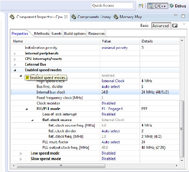

I found that program crashes in __initialize_hardware() function while MCGC1 register is setting. I configure internal bus clock 24MHz. When I set lower value of clock everything is ok.

This is my configuration:
Do you have any suggestion?

Solved. Firmware update of USB Multilink Universal helped.
