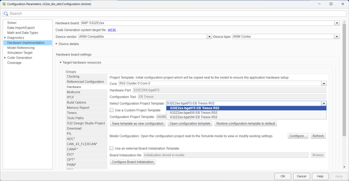

  • The toolbox has been tested and validated on the official NXP Evaluation Boards
    • S32E27X-DC
    • S32Z27X-DC
    • GreenBox 3 Rev. B
    • Only S32Z2/E2 chips with DSP/ML option B can use the SPF2 core and associated software

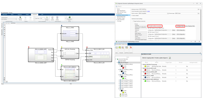

  •  Multicore support using Concurrent Execution from Simulink
    • Multicore support using Simulink Reference Configurations

  • Provides 2 modes of operation:
    • Basic – using pre-configured configurations for peripherals; useful for quick hardware evaluation and testing
    • Advanced – using S32 Configuration Tools or EB tresos to configure peripherals/pins/clocks
  • Default Configuration Project Templates targeting all the supported derivatives
  • Support for creating and using Custom Project Templates

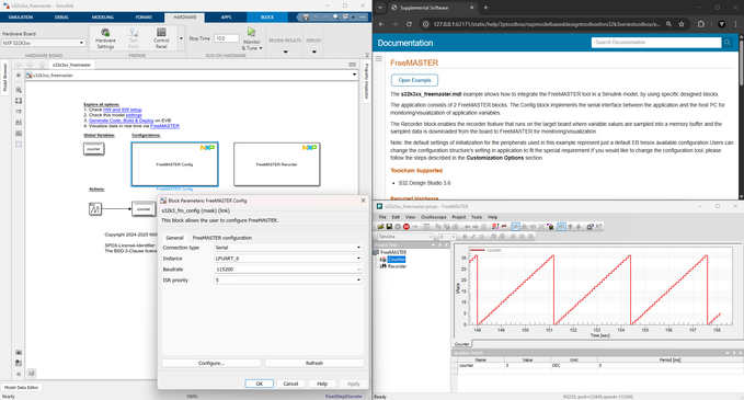

  • FreeMASTER Integration
We provide several Simulink example models and associated FreeMASTER projects to demonstrate how our toolbox interacts with the real-time data visualization tool and how it can be used for tuning embedded software applications.

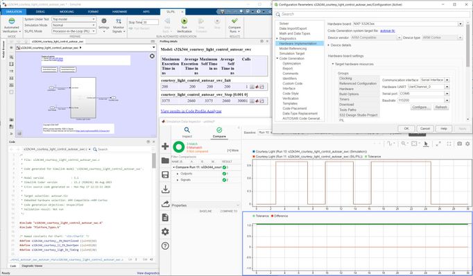

  • Simulation modes
We provide support for the following simulation modes (each of them being useful for validation and verification):
    • Software-in-Loop (SIL)
    • Processor-in-Loop (PIL)
