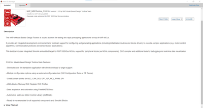

The Automotive Processing, Model-Based Design Tools Team at NXP Semiconductors, is pleased to announce the release of the Model-Based Design Toolbox for S32K3xx version 1.3.0. This release supports automatic code generation for S32K3xx peripherals and applications prototyping from MATLAB/Simulink for NXP S32K3xx Automotive Microprocessors. This new product adds support for S32K311, S32K312, S32K314, S32K322, S32K324, S32K341, S32K342, S32K344, S32K358 and S32K396 MCUs and part of their peripherals, based on RTD MCAL components (ADC, PWM, MCL, DIO, CAN, SPI, UART, GPT). To enable BMS applications development, we have added support for MC33775A and MC33772C battery cell controllers (& MC33665PHY). In this release, we have also updated S32 Configuration Tools, RTD, AMMCLib, and MATLAB support for the latest versions. The product comes with over 115 examples, covering everything that is supported, including demos for battery cell controllers (BCC) and motor control.

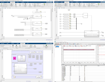

The toolbox provides support for the MC33775A, MC33772C, and MC33665. The MC33775A and MC33772C are lithium-ion battery cell controller ICs designed for automotive applications which perform ADC conversions of the differential cell voltages and battery temperatures, while the MC33665 is a transceiver physical layer transformer driver, designed to interface the microcontroller with the battery cell controllers through a high-speed isolated communication network. The ready-to-run examples provided with the MBDT for S32K3 show how to communicate between the S32K344 and the MC33775A and MC33772C via the MC33665 transceiver. For the MC33775A, the examples show how to configure the battery cell controller to perform Primary and Secondary chains conversion, and read the cell voltages conversion results from the MC33775A, while for the MC33772C the examples show how to configure the Battery cell controller to read current. All the converted values are displayed to the user over the FreeMaster application.

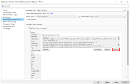

  • Support for component restore to default settings
The toolbox allows users to restore the configuration of a component (for models which use the EB Tresos configuration tool) to the settings corresponding to the Default Configuration Template the model uses. This allows reverting changes (if made) to the default values.

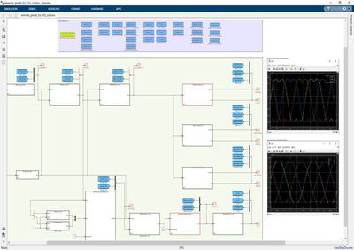

  • Integrates the Automotive Math and Motor Control Library release 1.1.31:
All functions in the Automotive Math and Motor Control Functions Library v1.1.31 are supported as blocks for simulation and embedded target code generation.

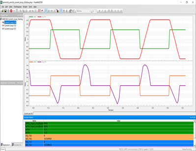

  • FreeMASTER Integration
We provide several Simulink example models and associated FreeMASTER projects to demonstrate how our toolbox interacts with the real-time data visualization tool and how it can be used for tuning embedded software applications.

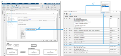

  • Board initialization:
The Model-Based Design Toolbox for S32K3xx generates the component’s peripherals initialization function calls as configured in the Board Initialization window. The toolbox provides a default configuration including function calls for initializing the clocks, followed by pins and a custom order for the rest of the peripherals which have been configured in the project associated to the model.

The NXP Model-Based Design Toolbox extends the MATLAB® and Simulink® experience by allowing customers to evaluate and use NXP’s S32K3xx MCUs and evaluation board solutions out-of-the-box with:
