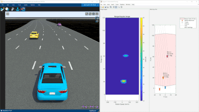

  • Radar processing demo – Automated Driving Toolbox scenario (updated)
    • Standalone and Processor-in-the-Loop (PIL) simulation
    • Range FFT, Doppler FFT, and Non-Coherent Combining offloaded to NXP SPT accelerator
    • MUSIC DoA offloaded to NXP LAX accelerator

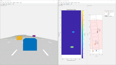

  • Radar processing demo – RoadRunner Toolbox scenario (new)
    • Processor-in-the-Loop (PIL) simulation
