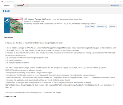

The Automotive Processing, Model-Based Design Tools Team at NXP Semiconductors, is pleased to announce the release of the Model-Based Design Toolbox for BMS version 1.0.0 EAR. This release is an Add-On for the NXP Model-Based Design Toolbox for S32K3xx 1.4.0, which supports automatic code generation for battery cell controllers and applications prototyping from MATLAB/Simulink. This new product adds support for MC33775A, MC33772C, MC33665A BCCs and part of their peripherals, based on BMS SDK components (Bcc_772c, Bcc_772c_SL Bcc_775a, Bms_TPL3_SL_E2E, Bms_common, Phy_665a). In this release, we have added the integration with the Model-Based Design Toolbox for S32K3xx version 1.4.0, added support for the BMS SDK 1.0.1, and MATLAB support for the latest versions. The product comes with battery cell controller examples, targeting the NXP HVBMS Reference Design boards.

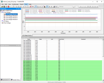

The toolbox provides support for the MC33775A, MC33772C, and MC33665. The MC33775A and MC33772C are lithium-ion battery cell controller ICs designed for automotive applications that perform ADC conversions of the differential cell voltages and battery temperatures, while the MC33665 is a transceiver physical layer transformer driver, designed to interface the microcontroller with the battery cell controllers through a high-speed isolated communication network. The ready-to-run examples provided with the MBDT for S32K3 show how to communicate between the S32K344, the MC33775A and MC33772C via the MC33665 transceiver. For the MC33775A, the examples show how to configure the battery cell controller to perform Primary and Secondary chains conversion, and read the cell voltages conversion results from the MC33775A, while for the MC33772C the examples show how to configure the Battery cell controller to read current. All the converted values are displayed to the user over the FreeMaster application.

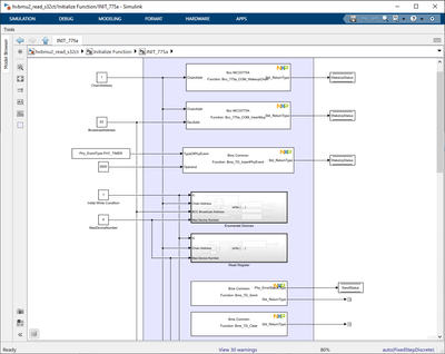

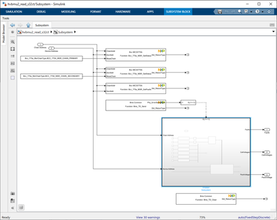

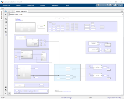

  • Examples of the functions supported:
    • MC33775A Configuration and data acquisition example
    • MC33772C Configuration and data acquisition example
    • RD-HVBMSCTBUN Configuration and data acquisition example
