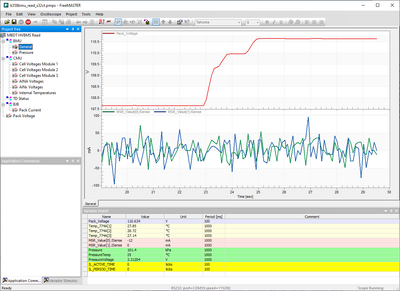

The toolbox provides support for the MC33775A, MC33774A, MC33772C, MC33664 and MC33665A. The MC33775A, MC3774A, and MC33772C are lithium-ion battery cell controller ICs designed for automotive applications performing ADC conversions of the differential cell voltages and battery temperatures, while the MC3366 and MC33665A are transceiver physical layer transformer drivers, designed to interface the microcontroller with the battery cell controllers through a high-speed isolated communication network. The ready-to-run examples provided with the MBDT for BMS show how to communicate between the S32K344/S32K358 and the MC33775A, MC33774A, and MC33772C via the MC33664/MC33665 transceivers.  For the MC33775A and MC33774A, the examples show how to configure the battery cell controllers to perform Primary and Secondary chain conversions and read the cell voltage conversion results from the MC33775A/MC33774A, while for the MC33772C the examples show how to configure the Battery cell controller to read the pack current. All the converted values are displayed to the user over the FreeMASTER application.

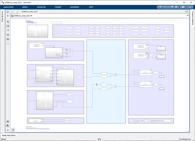

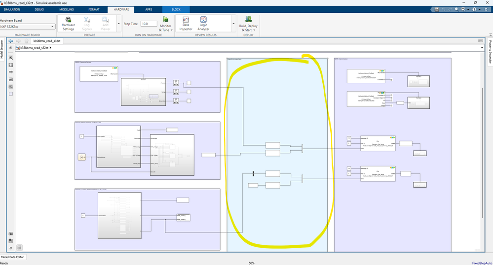

Hello @mariuslucianand ,
I have actually bought HVBMSCT800BUN for fast prototyping of BMS.
I am using MBDT solution for implementing the functionality of BMS.
Is there a direct C code generated for the whole solution including BMS blocks also in Simulink model itself?
In k358bmu_read_s32ct file, I could see readymade cofiguation for Cell controllers, freemasters but could not find block for BMS. I am attaching the screenshot for reference.
Does NXP also provide the BMS Algorithm block also? If yes, help me with this!
