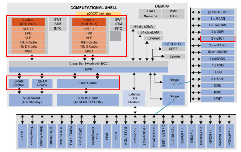

  • Added support for SIL, PIL and AUTOSAR Blockset code generation and simulation for the MPC5777C Ultra-Reliable MCU for Automotive and Industrial Engine Management. Currently only the basic enablement is available for this microcontroller as shown in the picture below:

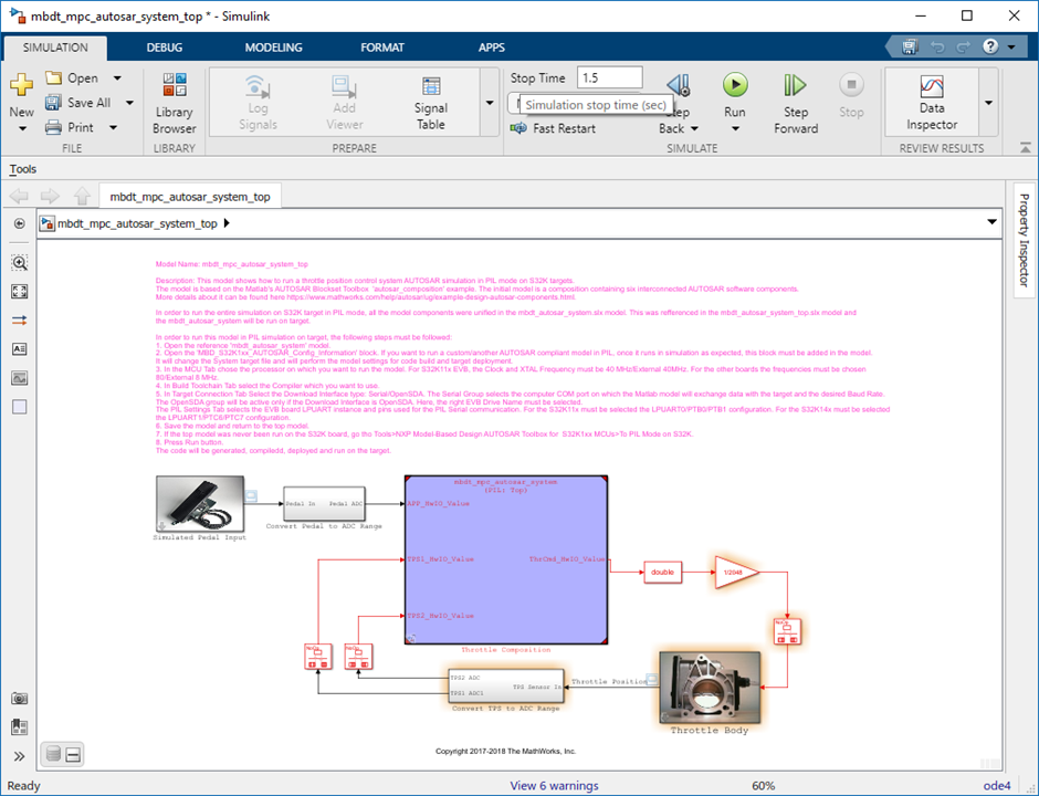

  • Enable MATLAB AUTOSAR Blockset on all MPC574xB/C/G/P and MPC5777C to allow users to configure, simulate, generate and profile AUTOSAR Applications with NXP Hardware;
