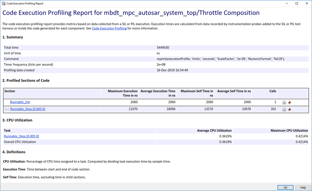

  • Added support for SIL, PIL and AUTOSAR Blockset code generation and simulation for the MPC5777C Ultra-Reliable MCU for Automotive and Industrial Engine Management. Currently only the basic enablement is available for this microcontroller as shown in the picture below:
  • Enhance MATLAB/Simulink support to all versions starting with 2016a to 2019b
  • Enable MATLAB AUTOSAR Blockset on all MPC574xB/C/G/P and MPC5777C to allow users to configure, simulate, generate and profile AUTOSAR Applications with NXP Hardware;

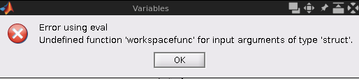

There is also a serious bug in 'mbd_mpc_path.m', it overwrites your entire MATLAB path.
The matlab function 'path' is invoked incorrectly:
    if nargin == 1 && strcmpi(varargin{1}, 'append')
        path([newpth pathsep rppth]);
        disp('MBD Toolbox path appended.');
    else
        path([rppth pathsep newpth]);
        disp('MBD Toolbox path prepended.');
    end
From the Matlab documentation: the existing path is never added.
path(P1,P2) changes the path to the concatenation of the two search
    paths P1 and P2.  Thus path(path,P) appends the folder P to the
    current path and path(P,path) prepends the folder P.  If P is already
    on the path, then path(path,P) moves P to the end of the path,
    and similarly, path(P,path) moves P to the beginning of the path.
The way it is currently setup it wipes out the original Matlab path, Matlab can't find anything, even help and eventually crashes.
Fix:
1. addpath([rppth pathsep newpth])
2. path(path, [rppth pathsep newpth]);
