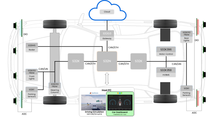

The dashboard the car project shown below was built using FreeMASTER, offering a powerful way to visualize and interact with embedded system data in real time. Dynamic gauges, graphs, and control panels create an intuitive interface that bring the application to life
Figure 1. Demo Car Project
A short demo video showcasing FreeMASTER highlights how easily you can monitor variables, tune parameters, and build a fully functional automotive dashboard, making it an excellent tool to accelerate development and spark interest in your own project.
(マイビデオを表示)
Figure 2. FreeMASTER Dashboard – in action
