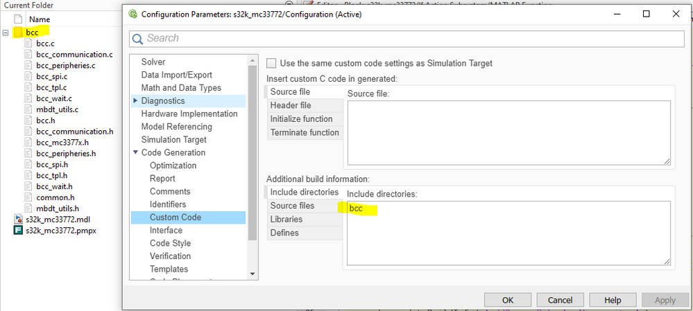

In order to include custom code, the user should follow these steps:
1. Add the directory path from which the Simulink will include the directories under Settings > Code Generation > Custom code > Include directories.
2. Insert a Matlab Function block in the Simulink model. This will be used for initialization. The goal here is to include the c headers in the generated code files. This requires to declare coder constant using the coder.const function. That has to be updated in the Build info using coder.updateBuildInfo . Here, the headers and the sources has to be included following this template:

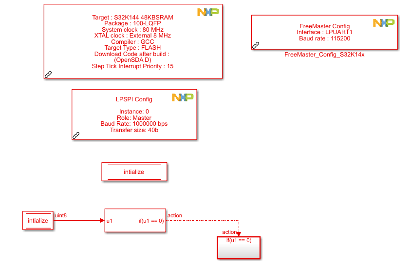

We created an S32K project for the S32K144 board, added the FreeMaster block and an LPSPI Instance according to the settings and the pin requirements by the MC33772 board. The Initialize variable will only be used to call the initialization sequence for the BMS.
Now, as we described in the previous chapter, we declared a folder "bcc" that contains the required drivers and some wrappers, also inserted in the Configuration parameters.

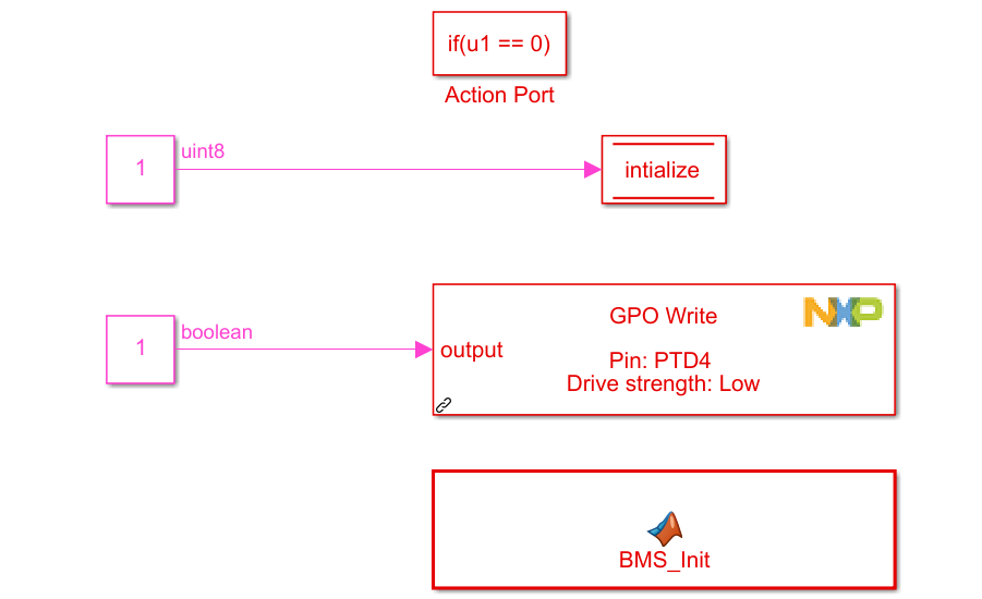

The initialize function contains a Matlab Call Function. This one includes all the steps described at the second point. What should be noticed here is the check from line 7. All that cinclude code will be called only when the coder.target is Rtw. If the user adds an else condition, that code will be called only when simulate. Now, MBD_MCC_Init is wrapper designed to perform all the initialization steps from the driver. It was easier like this.

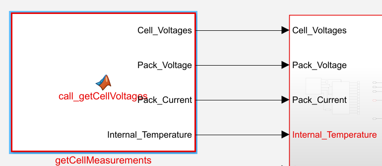

The MC33772 has been initialized so whenever the user needs the values, he/she must add a Matlab Function block that will provide the values to the model.
The code behind this block has been attached in the next image. The output values from the getCellMeasurements are provided as outputs and inside the get_cellVoltages, it will call the C updateMeasurements function using the coder.wref function.

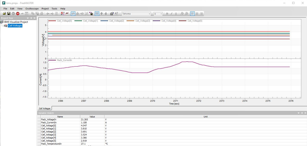

Running BMS
Now, after we solved some bugs during code generation Smiley Happy and had successfully built the code, we can run the generated code on the board. The following screenshot represents the Voltages and a variable Current measurement converted by the MC33772.

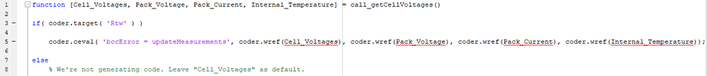

Indeed, those files does not exists in the driver. I wrote them and contains the wrappers used for initialization like MBD_BCC_Init function, where you can fill  the structure of settings and the function that actually measures the data. You can find them in the SDK FreeMaster example.
bcc_status_t updateMeasurements(float *cell_Voltages, float *pack_Voltage, float *pack_Current, float *internal_Temperature)
Also, inside it, I kept the initial function provided by the SDK, and I only transferred the measured data to the variables like here:
// MBDT Provide all required data in uV
cell_Voltages[0] = (float) cell1VoltageUV;
cell_Voltages[1] = (float) cell2VoltageUV;
cell_Voltages[2] = (float) cell3VoltageUV;
cell_Voltages[3] = (float) cell4VoltageUV;
cell_Voltages[4] = (float) cell5VoltageUV;
cell_Voltages[5] = (float) cell6VoltageUV;
*pack_Voltage = (float) stackVoltageUV;
*pack_Current = (float) isenseCurrentMA;
Note that the cell_Voltages is an array here, being provided as vector.
So the Entire BCC_MCU_ConfigureLPSPI() has to be Commented?
Not quite, the function must stay, I only commented the lines from 179->193   just after #if defined(SPI)
Also, when you write the call_getCellVoltages function, make an initialization for the Cell_Voltages with the type you need the variable and with a dummy values. Also, provide it as a pointer and you will be able to get all cells with a single array.
if( coder.target( 'Rtw' ) )
coder.ceval( 'bccError = updateMeasurements', coder.wref(Cell_Voltages), coder.wref(Pack_Voltage), coder.wref(Pack_Current), coder.wref(Internal_Temperature));
else
% We're not generating code
Cell_Voltages = single(3.7*ones(1,6));
Pack_Voltage = single(6.0*3.7);
Pack_Current = single(1.5);
Internal_Temperature = single(22.0);
end

Hello rathi.tg@araiindia.comoeren5@ford.com.tr‌,
As I've promised, I've attached the model running on 32K144EVB + FRDM33771BSPIEVB + BATT-14EMULATOR. Basically all the changes that oeren5@ford.com.tr‌ mentioned in the previous post are enough, but since you have the code now (attached at the end of the article), you can perform a diff.
The only requirement I have is to go to the BMS initialization/MATLAB Function and to replace the line 4 with the full path of the bcc folder in the archive.
This is how the FreeMaster project looks like with all the 14 cells battery values.
Now, please check the following points in order to get a valid communication.
1. the FRDM33771BSPIEVB contains some hardware jumpers configuration on the board that has to be changed in order to get a working communication. You cand find it at the chapter 2.4.1 FRDM33771BSPIEVB configuration in the UM11143  manual, the changes that you have to perform with the soldering iron on the board (just 6 jumpers)  in order to route directly the mC33771 pins to the S32K144 pins header.
2. I assume that the communication issue that rathi.tg@araiindia.com‌ mentions in his reply, that the board gets in idle is caused by a faulty communication either we talk about a hw or sw problem: the board gets no communication and after 60 seconds it enters standby mode.
3. If you are using the same setup as I do, please make sure that the emulator is powered up
Hope this helps,

Starting from today we have released the MBDT for S32K4.2.0 which adds support for MC3377xB in Mathworks and S32K. You can start from the model bms_s32k_mc33772b_spi.mdl.  Just change the Device in the MC3377xB Config Block and the model will work with the MC33771B.
So the model has an LPSPI Config block that configures the SPI peripheral. The MC3377xB Config block initializes the MC33771B Battery Cell Controller and as you can see here, it will provide an error status code. It will be good to add the variable in the FreeMaster and see the results. The error code is explained in the block's help so it will be easy to figure out what's wrong.
The MC3377xB Get Values block can start the conversion, wait until the conversion is ready and provide the results directly in milliAmps, microVolts, degrees Celcius, all human-readable values. All are cast to single, so if you need to transform from uV to V you only need to change the gain factor.
Let's give this a try and see how it works on your side.
Hope this helps,
Marius
