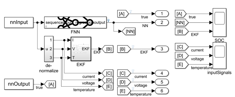

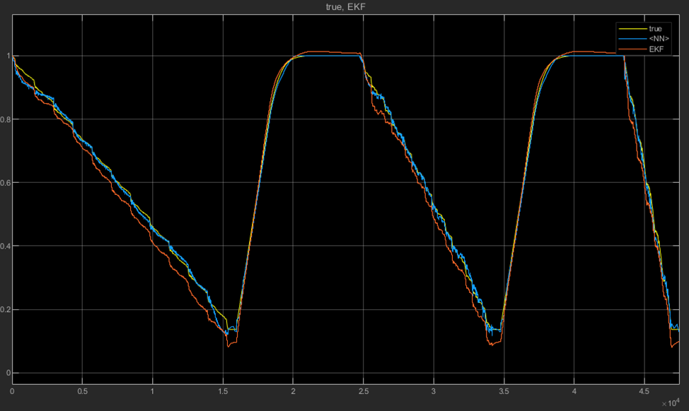

The BatterySOCSimulinkEstimation model included in the Deep Learning Toolbox computes the SoC estimation using two methods: first method uses a neural network and the second one uses the extended Kalman filter algorithm. By plotting data generated by these two estimations and comparing it to the true values, it is possible to validate that the FNN predicts the SoC with an accuracy of 3 within a temperature range between -10 C and 25 C.
Note! Before making any modification to the model included in the toolbox, it is recommended to create a backup of the example in order to be able to revert to the original state.
For this example, the predictions are done on the i.MX RT1060 evaluation board in PIL mode while the Kalman filter is locally computed on the computer.
Referenced Model

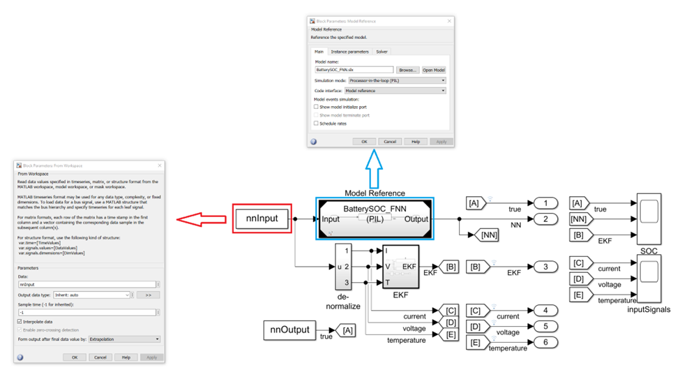

From the original model, the FNN block must be added in a new blank model. As the newly created model is used in a Referenced model, an input port must be added to received data (make sure the Port dimensions is set to 5), and one output port to return the data computed. The other settings for all these 3 blocks can be left default.

Top model
Based on the BatterySOCSimulinkEstimation model included in the Deep Learning Toolbox, the FNN block must be removed (either deleted or commented). A ModelReference subsystem must be added to the model. In the Block Parameters of the ModelReference subsystem, select the model created and configured above. Simulation Mode must be set to Processor-in-the-Loop (PIL). Another modification that must be done is the sample time of the nnInput Data Read Memory block which must be changed from 0 (continuous) to -1 (inherited).

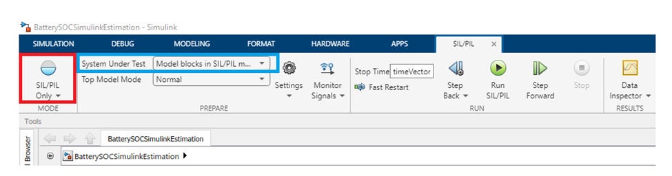

Deployment and validation
Now that both models (top model and referenced model) are configured, SIL/PIL manager can be opened from the APPS tab in Simulink. In the SIL/PIL tab, the simulation must be selected to SIL/PIL only (red rectangle) and the System Under Test to Model Blocks in SIL/PIL mode (blue rectangle).
Before the simulation is started, the BatterySOCSimulinkEstimation_ini.m script must be executed to load the necessary data into MATLAB's workspace. The script can be found next to the Simulink Model included in the Deep Learning Toolbox. From the top model, the SOC scope can be opened to display the generated data. The simulation can be started from the RUN button within the scope.
Note! Diagnostic Viewer can provide important information if there are any errors within the models.
If the simulation is successfully deployed on the target, the data plotted into the scope should look like this:

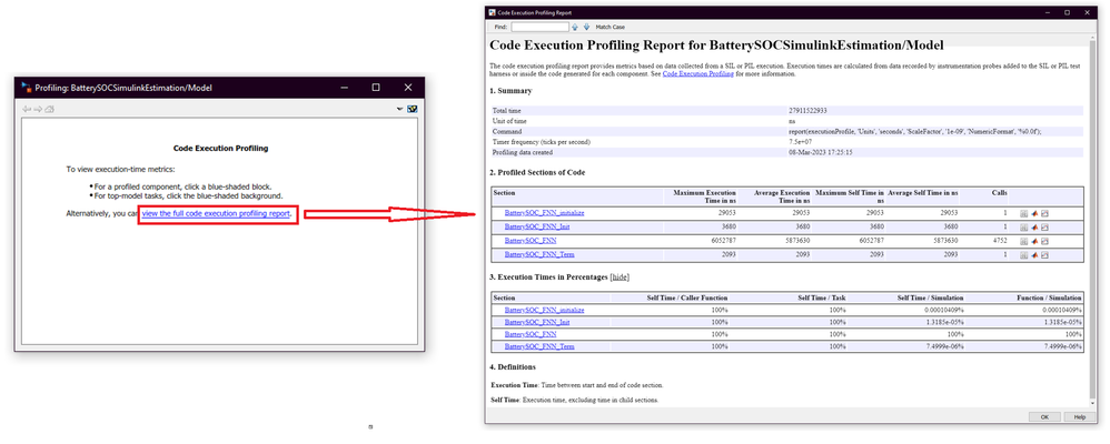

Code profiling
Code profiling is an important tool to validate an algorithm as it provides important information about the execution time. The time is measured by the timer configured in Model Settings -> Hardware Implementation -> Hardware board settings -> Target hardware resources -> Profiling Timers. By default, the PIT timer, channel 0, is used.
The Code generation can be enabled from Model Settings -> Code Generation -> Verification -> Code execution time profiling -> Measure task execution time. The generated report can either be Coarse (referenced models and subsystems only) or Detailed (all function call sites).
When the simulation is completed, a small window is opened. The Profiling report can be opened by clicking on the view the full code execution profiling report.
