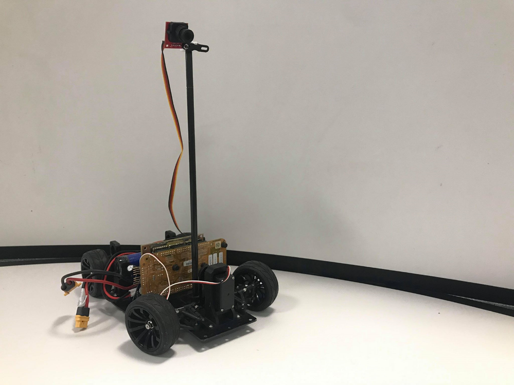

This article discusses various algorithms for controlling trajectory and speed for an autonomous vehicle.  The car is built with S32K144 and the NXP's Cup car chassis as explained in depth in this article: https://community.nxp.com/docs/DOC-341984. All software used for programming the car is done using MATLAB/Simulink toolbox called Model-Based Design Toolbox for S32K1xx - NXP Support Package S32K1xx - File Exchange - MATLAB Central. The goal of achieving imposed performances for this system is approached in a classical manner using a PID (Proportional Integral Derivative) controller and also by using modern control algorithms: LQG (Linear Quadratic Gaussian), LTR (Loop Transfer Recovery), H2 and H∞.
2. Vehicle Dynamics Model
A logical way of creating a formal representation of the physical system is described in the following section. The significant contribution of such representation is outlined in the control algorithms design process. Validation of these algorithms in a simulation environment, where a mathematical model approximates the real system, is a procedure which is going to be undertaken to ensure rectitude and precision for the developed solutions. Simplifying assumptions must be made to create the context of ease in manipulating such a formal representation, considering the existing numerical algorithms. Therefore, the mathematical model will possesses a certain level of compromise between the simplicity of the representation and accuracy related to the real system.

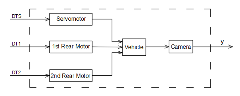

Before starting to model the car’s dynamics, a brief analysis of the system is introduced to offer a clear image on the process. The car can be controlled through three independent inputs, duty cycles which are given as inputs to the Simulink blocks: the duty cycle for the servomotor; the duty cycle for the 1st rear wheel and the duty cycle for the 2nd rear wheel. The output of the process is represented by the image camera sees in front of it, the array Y with the converted values of the analog signal transmitted by the sensor. Hence, a Multiple Input Single Output (MISO) process is modeled in the current section of the paper. The actuators are represented by the three motors, two to ensure traction of the car, and one servomotor responsible for the steering. The plant is represented by the actual vehicle, and the sensor is constituted by the camera which provides the image in front of the car. Thereby, Figure 2.1 illustrates the correspondence between the physical ensemble and the control theory components.
Figure 2.1 Actuators, plant, sensor

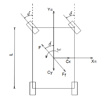

Before exposing the equations that describe the dynamics of the system, a representation of the forces that affect the vehicle is illustrated in Figure 2.2, where: XR and YR define the robot frame, δ represents the turning angle of the front wheels, F is the traction force generated by the two DC motors of the rear wheels, Ff denotes the friction force that the vehicle must overcome during its movement, L is the length of the car, measured from the center of the front wheels to the center of the rear wheels, Cx and Cy reactive forces depending on the movement velocity and ω the angular velocity.
Figure 2.2 Forces acting on the vehicle
Now, writing Newton’s law for the translation motion and considering the decomposition of the forces on the robot’s frame axis, the motion is described as well as longitudinal as latitudinal by:
The traction and resistance forces can be expressed based on the two DC motors parameters:
where: ui - voltage applied on the inner wheel motor, uo - voltage applied on the outer wheel motor (related to turning behavior), km - DC motor constant, rw - rear wheels diameter, R - winding resistance, Bv - resistance coefficient for the translation motion, μ - friction coefficient, M - mass of the vehicle, g - gravitational acceleration. When it comes to the rotational motion, the equation which describes the vehicle dynamics is given by:
where: MFx - moment of Fx force, Md - moment caused by the difference of speeds on the two rear wheels which triggers the car to change its orientation, MFfx - moment of Ffx force, which opposes to the rotational movement, Cw - reaction dependent to the angular velocity and J - moment of inertia.
Considering thus the previous formulas for the traction and friction force, the final equation of the rotational movement is:
where all the variables have the same meanings as already specified and more than that, Bw represents the resistance coefficient for the rotational motion.

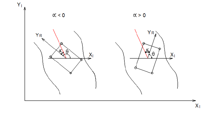

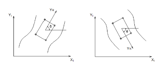

To express the position of the vehicle on the track, an approach based on angles is going to be used to provide a suitable functional description of the process. Therefore, θ represents the angle between the YR-axis of the robot and the XI-axis of an inertial frame, like in Figure 2.3 The θ angle provides information about the car’s position on the given track, and it represents the variable to be measured to ensure the desired behavior of the vehicle.
Figure 2.3 System output - θ angle

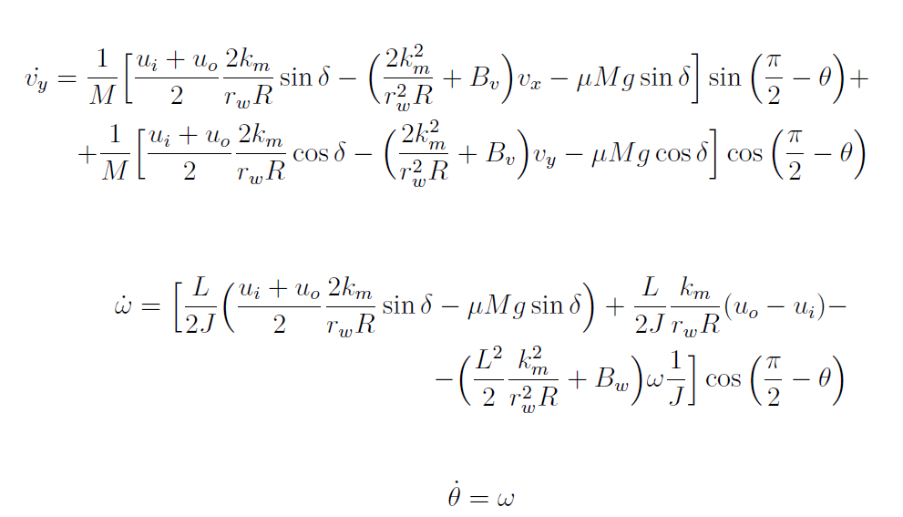

Therefore, the differential equations that model the vehicle’s dynamics are written in the inertial coordinate system and obtained considering a Newtonian approach as in:
The mathematical representation given by the previous differential equations is characterized by nonlinear dynamics. A linearization procedure is therefore implemented to obtain a state-space representation of the given model. For the particular model developed so far, considering the variables and their signification related to the vehicle’s dynamics, the state array is formed by: x' = [θ vx vy ω], while θ represents the output and u' = [δ ui uo] defines the control signals array.

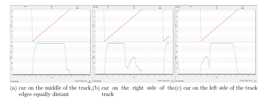

3.1.1 Position Computing and Reference Defining
Relying on the array of intensities returned by the ADC, the following procedure was undertaken to gain knowledge about what the camera sees. The robot was firstly placed on one side of the track, and connected to the FreeMaster tool for real-time data collecting. The experiment was repeated for different positions of the vehicle, and the results are illustrated in the figures below:
Figure 3.1.1.1 Exemplification of what camera sees for different positions of the car on the track
Noticing how the image in front of the camera changes related to its position, it is desirable for the two dips on the graphics to be equally distant from the center of the array. A position finding algorithm is therefore implemented for searching the edges of the road.

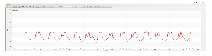

The result of the designed controlled system is now illustrated in Figure 3.1.2.1, extracted from the FreeMaster debug tool in real time, while the car completes multiple laps on the given track.The output of the system is illustrated on the Y-axis, the reference is marked with a black line, and the time scale is represented on the X-axis, in seconds. The dips on the graphical representation of the system’s output correspond to the curvatures of the road, where a significant error triggers the wheels steering to keep the car on the track. The wavy portion is the system’s output on the wavy piece of the road, and the almost straight area is the output provided when the car is on the straight piece of the track. It is noticeable that on the straight part of the track, the reference is not completely followed. Also, on a long straight road, only the proportional component is not able to ensure a steady state error equal to zero.
Figure 3.1.2.1 System reference and output with P controller
Figure 3.1.2.2 Track components: straight, curve, wavy
Rising even more the KR factor value does not solve this problem, because the risk of the system’s instability appears in this scenario. Thus, the integrative component should be used, and now the controller is a PI, with the following control law:
The Ti value is chosen experimentally, and satisfying results are illustrated in the following figure:
Figure 3.1.2.3 System reference and output with PI controller

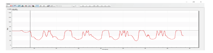

The center of the track is now followed, and the behavior of the vehicle is as desired. On longer tracks, the vehicle movement seems like a crawl, and the particularities of the system allow the control of three different inputs. A speed control algorithm is thus implemented to ensure a reduced time in completing a lap.

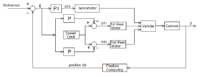

Like any other car, the robot should be able to adapt its speed depending on the track to be traversed. Acceleration and deceleration features should be implemented into the current application to emulate the behavior of a real-life vehicle. Also depending on the road’s particularities, curvatures, distances, a speed limit should be left to be user’s choice.
Intuitively, from a driver perspective, the speed should be reduced at the beginning of the curve and then gradually increased on the second part of the curve, as the car leaves it and heads to a straight piece of the road. Taking into consideration this real life behavior, the graphic evolution of the output of the system controlled with the PID position controller seems to illustrate this exact idea. It is noticeable that inside a curve, the error slowly increases as the car approaches the center of the turn, and then decreases while the exit becomes close. A proportional control signal to the speed of the two wheels can be thus computed to take care of this operating mode.The error signal is consequently fed to a P controller which amplifies it considering, for the beginning, that the maximum speed allowed is equal to 0.15 (15%). Therefore, the control loop is completed, as illustrated in the figure below:

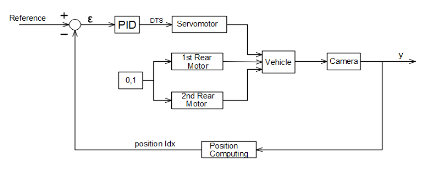

Figure 3.2.1 Position and speed control loop

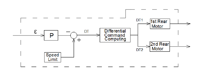

Assuming that the imposed speed limit is provided by a duty cycle equal to 0.15, as specified in the previous paragraph, and also that, during a turn, it must be reduced to 0.1, the KR factor of the two controllers, one for each rear wheel is given by:
The KR general formula can be modified under the desired speed range (how fast should the car go and how fast should it take turns). The control signal given to the rear motors, uk = KRϵk is subtracted from the imposed speed limit to achieve the desired behavior on the curvatures of the road. The car travels the track faster now, but increasing the speed, even more, causes a side-slip of the vehicle during turns. This shortcoming could be improved by taking advantage of the fact that the two rear wheels can be controlled independently. Hence, inside a turn, the outer wheel should have a bigger rotation speed than the inner one, in the same way, an automobile operates. This differential control of the traction wheels is used to increase the stability of the system, improving, therefore, the performances of the vehicle.
However, a way of computing the difference between the speeds of the two rear wheels must be implemented. The overall speed of the moving vehicle is given by the two duty cycle control signals, and it is:
The ratio between the outer wheel speed and the inner wheel speed is experimentally chosen based on the formula:
The experimental procedure is undertaken for obtaining a suitable value for the speed ratio started by choosing this factor equal to 1. For a speed ratio equal to 1 there is no differential control of the rear wheels, both of them having the same rotation speed. The speed ratio produced satisfactory results for a value equal to 1.3. A 1.4-speed ratio factor is also suitable for the application, but increasing it more could cause unwanted behaviors such as the car turning around its axis.
With a 1.3-speed ratio factor, a 20% (0.2) speed limit was achieved, with a lower value of 15% (0.15) during turns. Increasing the speed, even more, 25% (0.25) and keeping the lower value at its previous setting produces, in some cases, side-slips of the vehicle outside the track. By reducing the vehicle turning speed, for example, 10% (0.1) does not solve the side-slip issue. The leading cause of this behavior is related to the oval shape of the track, with short straight segments. As on a winding road, the robot should also limit its speed because sudden acceleration and deceleration actions cause undesired system’s reactions and safety issues are definitely to be considered during control algorithms design. Mixing this way of computing two different duty cycles for the two rear wheels, with the proportional controller introduced in the first part of this subsection, which will provide the overall DT, the vehicle shows more stability during the turns than it did without the differential speed control and a bigger speed can be achieved without losing the position requirements.

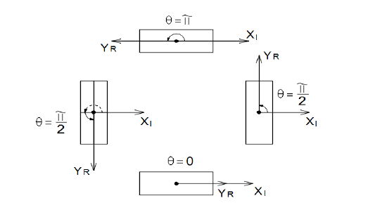

However, the simulation does not recognize the output of the system as an angle. Considering the work in a digital environment, its values are increasing and decreasing following the given inputs. This behavior is as expected, assuming that a constant speed on the rear wheels and a certain angle of the front ones produces a variation of the output, increasing or decreasing its value based on the steering direction. However, the output θ is an angle, so the subsequent processing of the signal is realized. The following assumptions are made: the value of θ is measured trigonometrical; the minimum value for θ is 0 radians, and the maximum value for θ is π.
It is natural that for bigger angles than π, the real value of the angle is computed by theta real = theta measured − π. Before applying this verification and then modification of the measured value, it must be made sure that the output of the system is not negative; therefore a Simulink block is used to compute its absolute value.
Figure 3.3.1.1 Theta angle conversion
As noticeable in the previous figure, the system’s output changes its value when the vehicle is going inside curvature of the road, for example. As assumed during the linearization procedure, the car starts its movement from a position which is perpendicular on the X-axis of the inertial coordinate system, thus leading to a θ equal to π/2 .

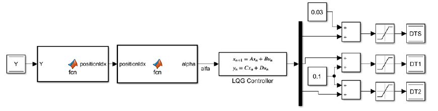

Firtsly, an LQG controller is implemented in the Simulink environment using the lqg Matlab function:
where sys is the state-space representation of the system given by the A,B,C and D matrices. QXU is the penalty matrix considering that the cost function to be minimized by the algorithm is written as:
The QWU noise covariance matrix is given by:
The control signal is computed with the help of an LQR (Linear Quadratic Regulator) such that J reaches is minimum value. A Riccati equation depending on the state-space representation of the system and the penalty matrices Q and is solved with this purpose, but these details are not subject of the current description. However, for obtaining such a controller, a full state array x is required. The feasibility of this assumption is not guaranteed considering that in many control problems, not all the state components are measurable. If moreover, the process is affected by noise, a Kalman filter has to be used. After the Kalman filter estimates the full state of the system, the LQR algorithm computes optimally the control signal, based on the state estimation. This procedure is called the synthesis of a LQG controller.
Considering the penalty of the state deviation which needs to be accomplished and also the control signals limitations required for a safety operation mode, the values of these matrices are chosen conveniently. The returned controller is given by a state-space representation which is introduced into a state-space block in Simulink, and connected to the system considering a classical control loop. However, before doing so, the obtained controller is sampled with a convenient sampling period to ensure the functionality of the given process, using the c2d Matlab command.
The control signals given by the discrete controller, before being fed to the system, are added to their linearization values and saturation blocks are also used to prevent the damages a very high control signal can produce on the system’s actuators. The implementation on the real system is illustrated in the figure below, where the deviation based on the array returned from the camera is given to the controller as an error signal, as mentioned previously.
Figure 3.3.2.1 LQG control loop on the real system

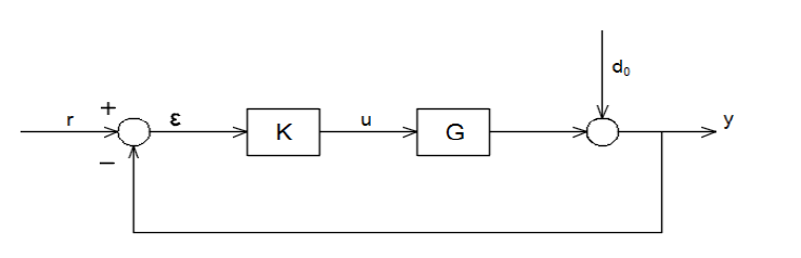

Figure 3.4.1 Standard control loop
Computing a controller that satisfies the imposed performances requires the consideration of the system in a generalized form given by:
In such a configuration, the partition of the inputs and the outputs has the following signification: u1 - external inputs (disturbances, noises, references); u2 - controlled inputs;
y1 - controlled outputs (errors to be minimized, control signals to be bounded); y2 - measured outputs. In the case of the current application, this translates into:

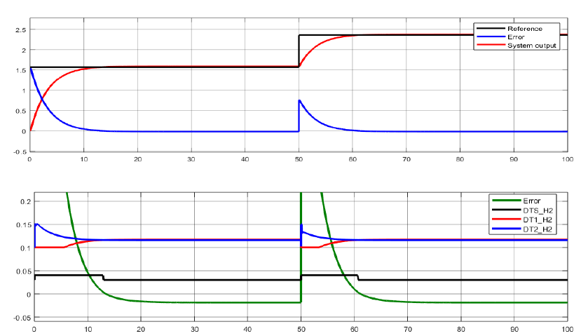

For each of the computed controllers, simulations are realized to validate their functionality on the given system. Each closed loop is analyzed for a step reference signal and the results are illustrated in the figures below:

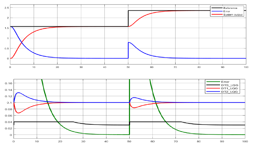

Figure 4.1 Reference tracking and control signals computed by the LQG controller for a step reference

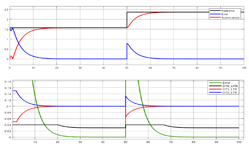

              Figure 4.2 Reference tracking and control signals computed by the LTR controller for a step reference
            Figure 4.3 Reference tracking and control signals computed by the H2 controller for a step reference

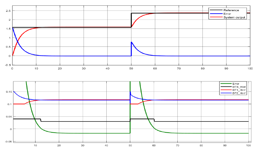

                                                          Figure 4.4 Reference tracking and control signals computed by the H∞ controller for a step reference
The signals evolution over time, as noticeable in the illustrated graphics, does not highlight significant differences between the designed control algorithms. Control signals evolution over time also reflects with accuracy the real behavior of the car. For a positive error, one of the duty cycles of the rear wheels increases, while the other one decreases. For a negative error, they change their evolution symmetrically, thus differentiating between the two types of turning, to the left, respectively to the right. In the same time, the duty cycle control signal given to the servomotor shows a variation between 0.04 for a positive error and 0.02 for a negative one, keeping its values constant at 0.03 when no error is computed.
However, H2 and H∞ algorithms represent powerful tools which do not exhibit their full-capacity advantages due to the low complexity of the system’s model. Therefore, a proportionate effort should be put into solving a real-life problem, considering its complexity and performance requirements. The LQG and LTR can also be interpreted as a particular case of the H2 control problem, as detailed in, this explaining the similarity between the time domain solutions between these two algorithms and H2. When it comes to the H∞ method, no significant advantages are enlightened by the time domain graphical evolution either. What is yet remarkable at this control option is represented by the advantages presented in the case of unstructured perturbations affecting the system’s model. As already mentioned in the paper, the nominal model approximates the real system. Therefore a behavioral uncertainty is present throughout the entire design process. Robustness related to this estimations is achieved with the H∞ control option.
However, a statistical comparison is illustrated in the following table, which contains the values of the step-response characteristics, computed for the closed loop systems. Considering that the sampling time used for the simulation is equal to 0.02s, as mentioned in the previous chapter, the results are as in the following table:
