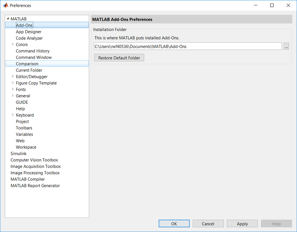

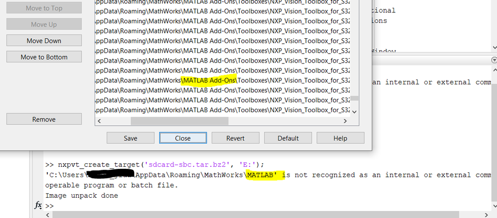

Seems I got an error related with the space in path string when I am trying to exe nxpvt_crate_target command.
Please help.
JD
Hi JimDuan‌,
This is a known limitation of the Vision SDK which does not support spaces in the project directory or SDK directory. You could change the path to one that has no spaces from Home => Preferences => Add-ons:
Please let me know if you encounter any other problems.
Thank you,
nxf40536
