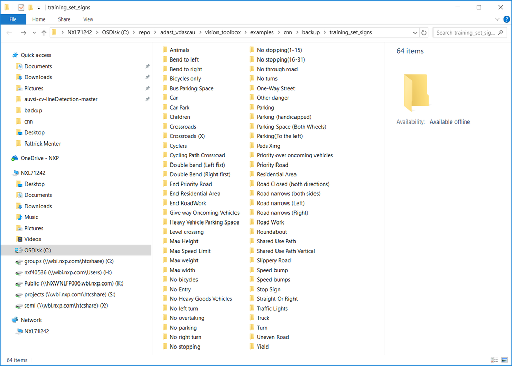

2.1 CONFIGURING THE DATASET

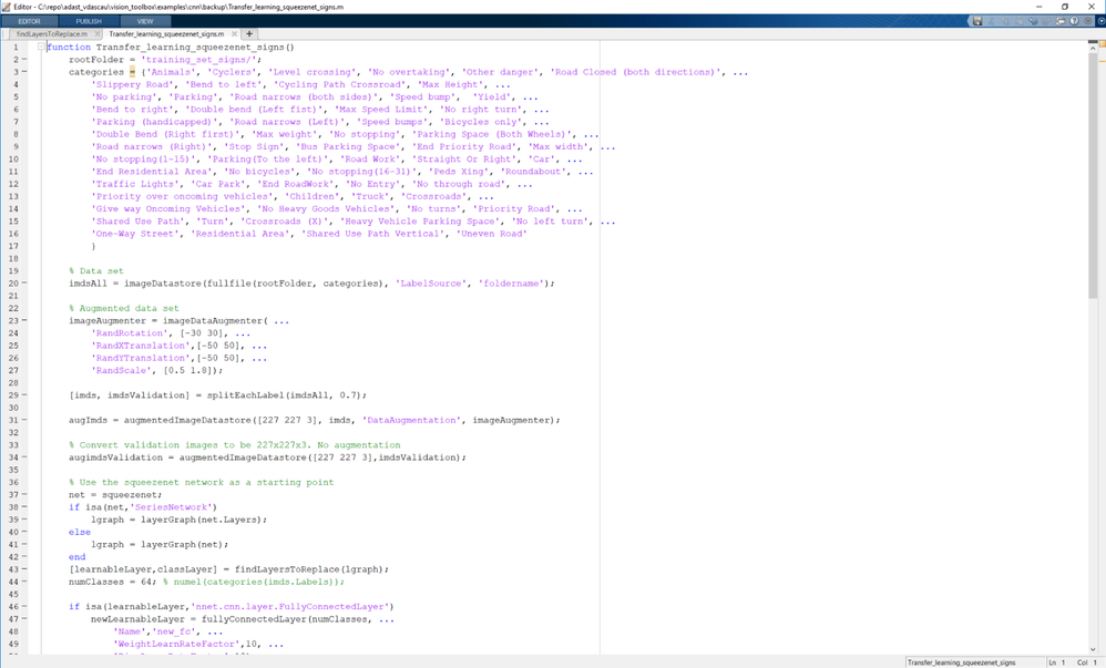

After downloading the dataset, we have renamed all the folders to the class they represent (traffic sign name). The raw data is divided into 62 classes (00000 - 00061) :
As you can see we have also added the Cars and Trucks folder with our own data. First thing we need to do is to actually set the class names in a variable called categories that will hold the names of all folders in the training_set_signs folder.

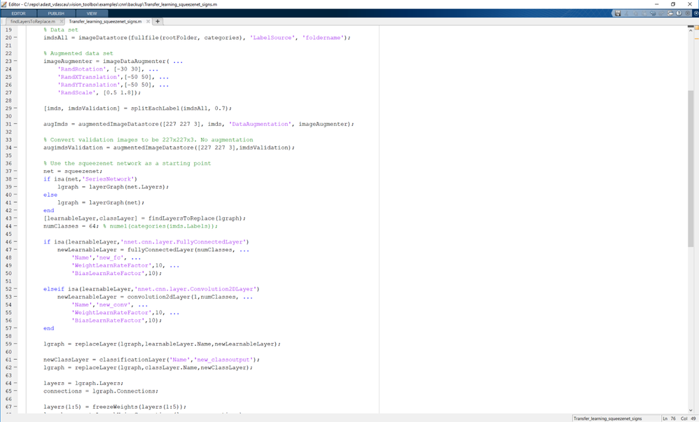

2.2 AUGMENTING THE DATASET
Before actually diving into (re)training a CNN, MATLAB provides a way to increase the input dataset on the fly, preventing over-fitting and allowing users to get the most of their data. Over-fitting occurs when you achieve a good fit of your model on the training data, while it does not generalize well on new, unseen data. In other words, the model learned patterns specific to the training data, which are irrelevant in other data.
In MATLAB, this step only boils down to configuring a set of preprocessing options for augmenting the image, using a special object. An augmented image datastore transforms batches of training, validation, test, and prediction data, with optional preprocessing such as resizing, rotation, and reflection. It also allows resizing the available images to make them compatible with the input size of the deep learning network. For a complete overview of MATLAB's capabilities regarding this subject, visit https://www.mathworks.com/help/deeplearning/ug/preprocess-images-for-deep-learning.html#mw_ef499675-... .
Augmenting the data in our example consists of applying:
  • random rotations ( -30 degrees to 30 degrees )
  • random X and Y translations ( -50 to +50 pixels )
  • scaling/zooming ( 0.5 to 1.8).
The datastore automatically resizes the input images to 227x227x3, which is the format that SqueezeNet was trained on and the only image format it accepts:

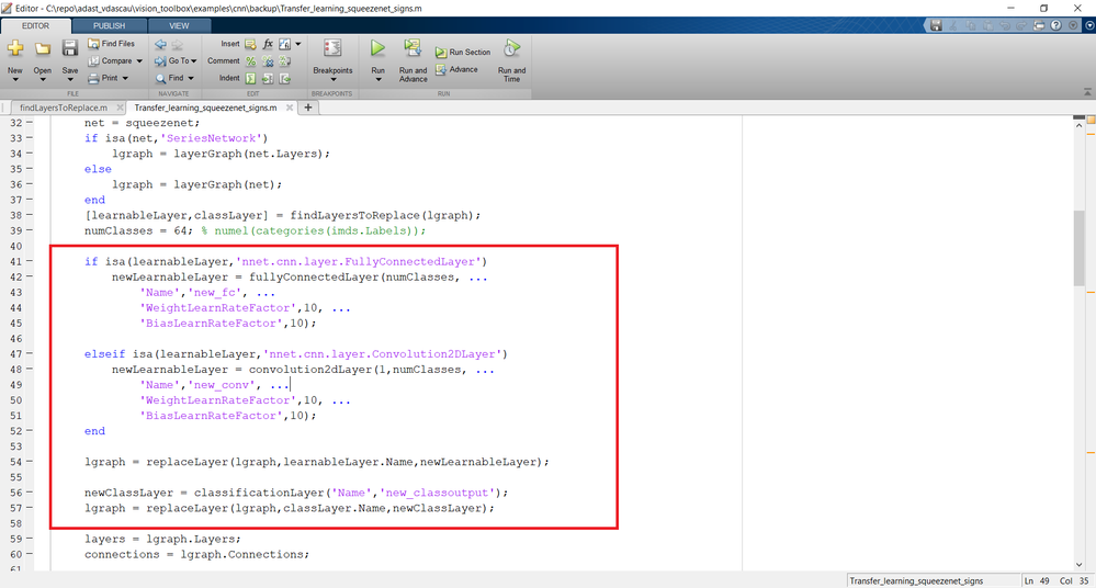

To retrain a pretrained network to classify new images, we need to replace these two layers with new layers adapted to the new data set. We first extract the layer graph from the trained network. If the network is a SeriesNetwork object, such as AlexNet, VGG-16, or VGG-19, then the list of layers in net.Layers to a layer graph gets converted into a LayerGraph.
In most networks, the last layer with learnable weights is a fully connected layer. Replace this fully connected layer with a new fully connected layer with the number of outputs equal to the number of classes in the new data set (5, in this example). In some networks, such as SqueezeNet, the last learnable layer is a 1-by-1 convolutional layer instead. In this case, replace the convolutional layer with a new convolutional layer with the number of filters equal to the number of classes. To learn faster in the new layer than in the transferred layers, increase the learning rate factors of the layer.

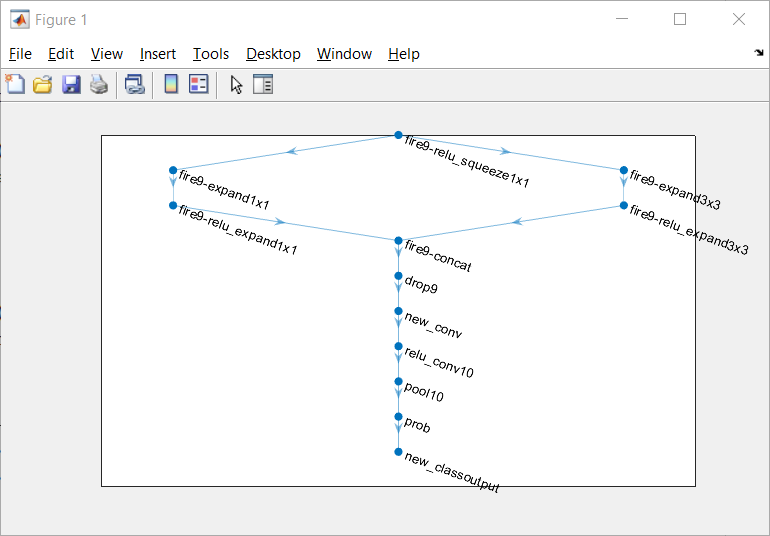

Finding the layers to be replaced is done with the helper function findLayersToReplace which is provided by MATLAB in one of their example. You can find it attached here if you want to understand more on how it is used to determine the layers that have to get replaced. The classification layer specifies the output classes of the network, thus we have to replace the classification layer with a new one without class labels. The trainNetwork function automatically sets the output classes of the layer at training time. To check that the new layers are connected correctly, we can plot the new layer graph and zoom in on the last layers of the network:

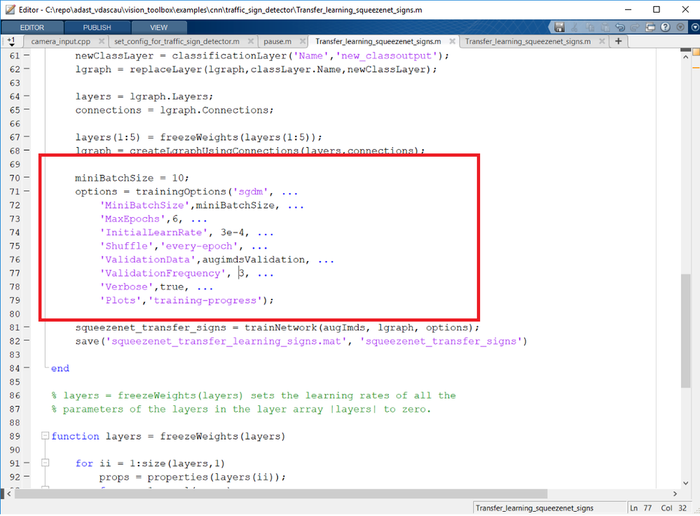

The network is now ready to be retrained on the new set of images. Optionally, you can "freeze" the weights of earlier layers in the network by setting the learning rates in those layers to zero. During training, the trainNetwork function does not update the parameters of the frozen layers. Because the gradients of the frozen layers do not need to be computed, freezing the weights of many initial layers can significantly speed up network training. If the new data set is small, then freezing earlier network layers can also prevent those layers from over-fitting to the new data set.
Extract the layers and connections of the layer graph and select which layers to freeze. We will make use of the supporting function createLgraphUsingConnections to reconnect all the layers in the original order. The new layer graph contains the same layers, but with the learning rates of the earlier layers set to zero:
3. RETRAINING THE MODEL
The actual training is done is the next code snippet. We provide the training options in a trainingOptions structure with a set of parameters ( which, by the way, can be tweaked in an attempt to increase accuracy ). We are using SGDM  ( Stochastic Gradient Descent with Momentum ) optimizer, mini-batches with 10 observations at each iteration, an Initial learning rate of 0.0003 and a total of 6 epochs for the training process. Training with this parameters took 32 minutes with a Single CPU hardware resource and achieved a pretty decent 84% validation accuracy level.The training duration can be dramatically improved by using a GPU and the Parallel Computing Toolbox from MATLAB.

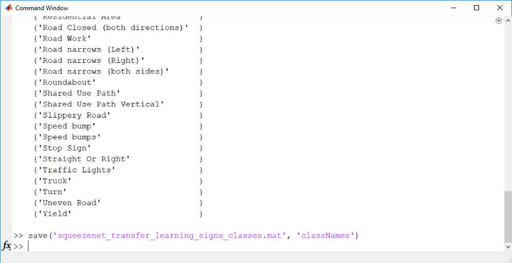

Last thing we want to do before actually testing all the work we've done is to save the classNames for the generated CNN:

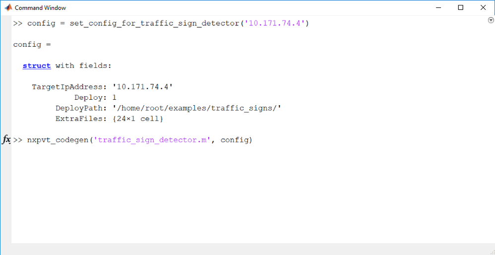

 To run it on the target board, you should copy the input images to the board. To do that, you can use the helper set_config_for_traffic_sign_detector.m :

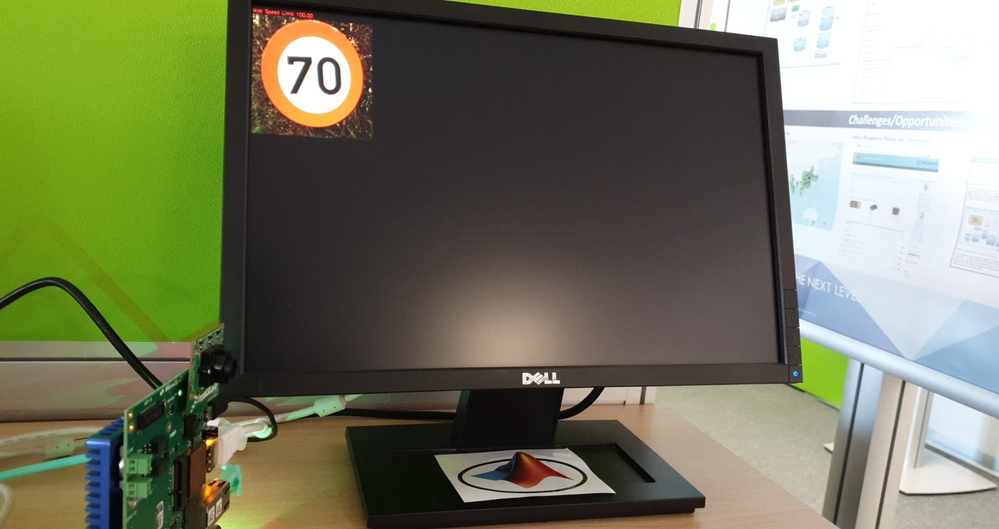

   You now should be getting the expected results from the board:
