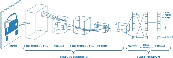

A convolutional neural network (CNN or ConvNet) is one of the most popular algorithms for deep learning, a type of machine learning in which a model learns to perform classification tasks directly from images, video, text, or sound. CNNs are particularly useful for finding patterns in images to recognize objects, faces, and scenes. Such algorithms learn directly from image data, using patterns to classify images and eliminating the need for manual feature extraction.
CNNs provide an optimal architecture for image recognition and pattern detection. Combined with advances in parallel computing, CNNs are a key technology underlying new developments in automated driving and facial recognition.
2.1 Feature Detection

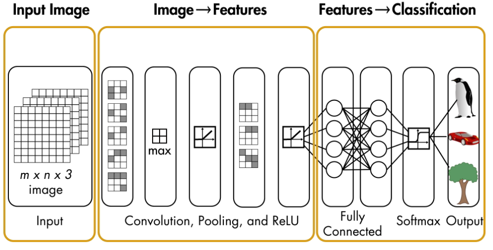

A convolutional neural network can have tens or hundreds of layers that each learn to detect different features of an image. Filters are applied to each training image at different resolutions, and the output of each convolved image is used as the input to the next layer. The filters can start as very simple features, such as brightness and edges, and increase in complexity to features that uniquely define the object.
Like other neural networks, a CNN is composed of an input layer, an output layer, and many hidden layers in between. These layers perform operations that alter the data with the intent of learning features specific to the data.
Three of the most common CNN layers are:
  • Convolution: puts the input images through a set of convolutional filters, each of which activates certain features from the images. The Convolution layer uses a filter matrix over the array of image pixels and performs convolution operation to obtain a convolved feature map.
  • Rectified linear unit (ReLU): allows for faster and more effective training by mapping negative values to zero and maintaining positive values. This is sometimes referred to as activation, because only the activated features are carried forward into the next layer.
  • Pooling simplifies the output by performing nonlinear down sampling, reducing the number of parameters that the network needs to learn
These operations are repeated over tens or hundreds of layers, with each layer learning to identify different features.
After learning features in many layers, the architecture of a CNN shifts to classification. The next-to-last layer is a fully connected layer that outputs a vector of K dimensions where K is the number of classes that the network will be able to predict. This vector contains the probabilities for each class of any image being classified.
The final layer of the CNN architecture uses a classification layer such as softmax to provide the classification output. The softmax activation function is often placed at the output layer of a neural network. It’s commonly used in multi-class learning problems where a set of features can be related to one-of-K classes. For example, in the CIFAR-10 image classification problem, given a set of pixels as input, we need to classify if a particular sample belongs to one-of-ten available classes: i.e., cat, dog, airplane, etc. Its equation is simple, we just have to compute for the normalized exponential function of all the units in the layer. Intuitively, what the softmax does is that it squashes a vector of size K between 0 and 1. Furthermore, because it is a normalization of the exponential, the sum of this whole vector equates to 1. We can then interpret the output of the softmax as the probabilities that a certain set of features belongs to a certain class.

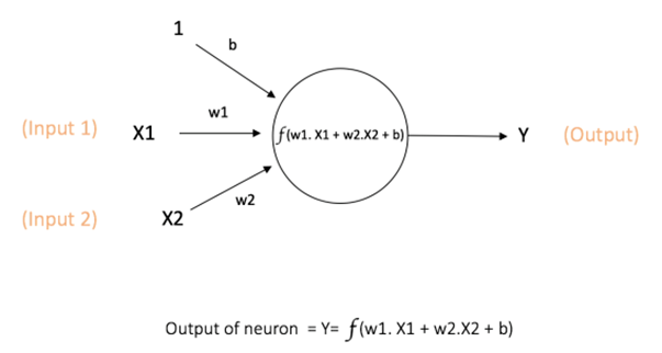

 CNNs, like neural networks, are made up of neurons with learnable weights and biases. Each neuron receives several inputs, takes a weighted sum over them, passes it through an activation function and responds with an output. The basic structures of neural networks are perceptrons. The perceptron is depicted in the below figure:
The perceptron consists of weights (including a special weight called bias) , summation processor and an activation function. In same cases there is an extra input node called a bias. All the inputs are individually weighted, added together and passed into the activation function.
Every activation function (or non-linearity) takes a single number and performs a certain fixed mathematical operation on it. There are several activation functions that are encountered in practice:
  • Sigmoid: takes a real-valued input and squashes it to range between 0 and 1
               σ(x) = 1 / (1 + exp(−x))
  • tanh: takes a real-valued input and squashes it to the range [-1, 1]
               tanh(x) = 2σ(2x) − 1
  • ReLU: ReLU stands for Rectified Linear Unit. It takes a real-valued input and thresholds it at zero (replaces negative values with zero)
               f(x) = max(0, x)
The main function of Bias is to provide every node with a trainable constant value (in addition to the normal inputs that the node receives).
In a nutshell, a perceptron is a very simple learning machine. It can take in a few inputs, each of which has a weight to signify how important it is, and generate an output decision of “0” or “1”. More specifically it is a linear classification algorithm, because it uses a line to determine an input’s class. However, when combined with many other perceptrons, it forms an artificial neural network.

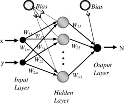

A Multi Layer Perceptron (MLP) contains one or more hidden layers (apart from one input and one output layer).  While a single layer perceptron can only learn linear functions, a multi layer perceptron can also learn non – linear functions.
All connections have weights associated with them, each layer having its own bias. The process by which a Multi Layer Perceptron learns is called the backpropagation algorithm. Initially all the edge weights are randomly assigned. For every input in the training dataset, the Neural Network is activated and its output is observed. This output is compared with the desired output that we already know, and the error is “propagated” back to the previous layer. This error is noted and the weights are “adjusted” accordingly. This process is repeated until the output error is below a predetermined threshold. The process of "adjusting" the weights makes use of the Gradient Descent algorithm for minimizing the error function, which we will not go into details about.

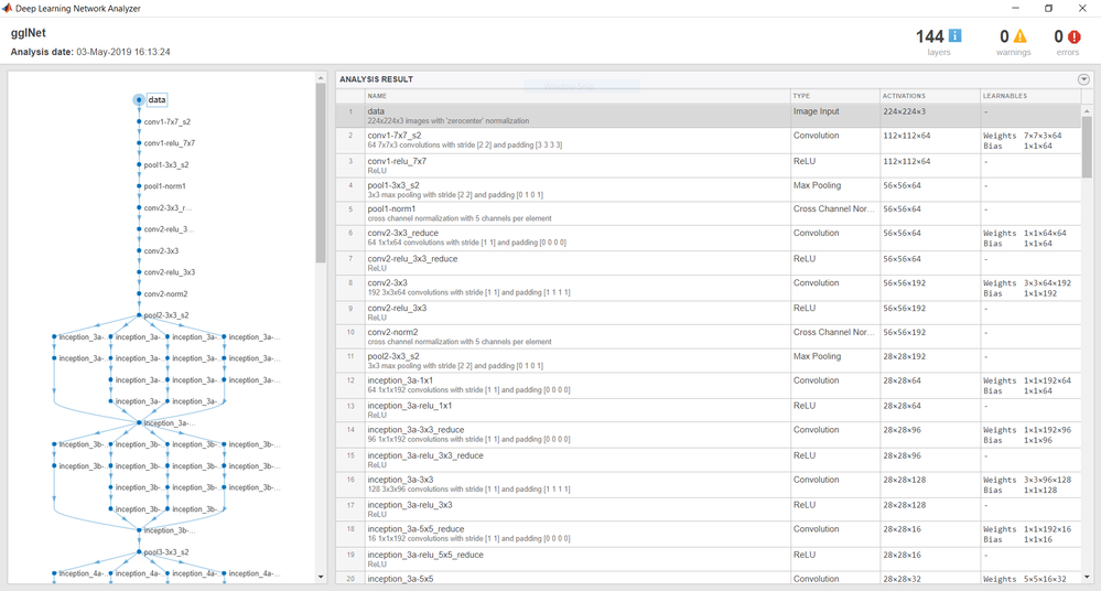

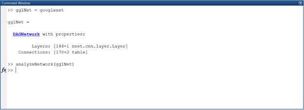

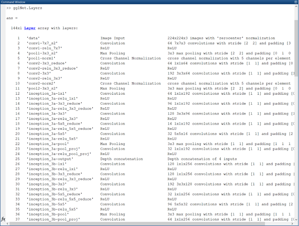

Using just the command in the above Command Window, we were able to get a hold of the GoogLeNet pretrained model in MATLAB. One can inspect the network layers in detailes by calling the analyzeNetwork function:
As you can see the network is made up of a bunch of layers connected as a DAGNetwork (Directed Acyclic Graph Network).
   DAGNetwork properties:
        Layers              - The layers of a network
        Connections     - The connections between the layers
    DAGNetwork methods:
        predict         - Run the network on input data
        classify        - Classify data with a network
        activations     - Compute specific network layer activations.
        plot            - Plot a diagram of the network

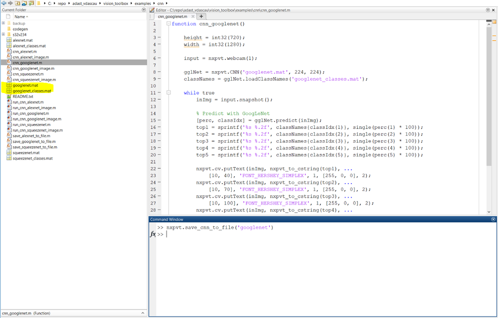

The layers are pretty much standard, except that there are some Inception layers specific to GoogLeNet. Inception layers of GoogLeNet consist of six convolution layers with different kernel sizes and one pooling layer.  To create a GoogLeNet convolutional neural network object with the NXP Vision Toolbox one should get a hold of the .mat saved from the GoogLeNet object in Matlab as well as the classes within it. This can be done using the nxpvt.save_cnn_to_file(cnnObj) wrapper provided in the toolbox:
As you can see, the googlenet.mat and googlenet_classes.mat files are created which can then be used to create the nxpvt.CNN wrapper object. The creating, the simulation and the deployment of these objects and algorithms will be discussed in detail in a future document.

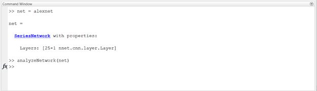

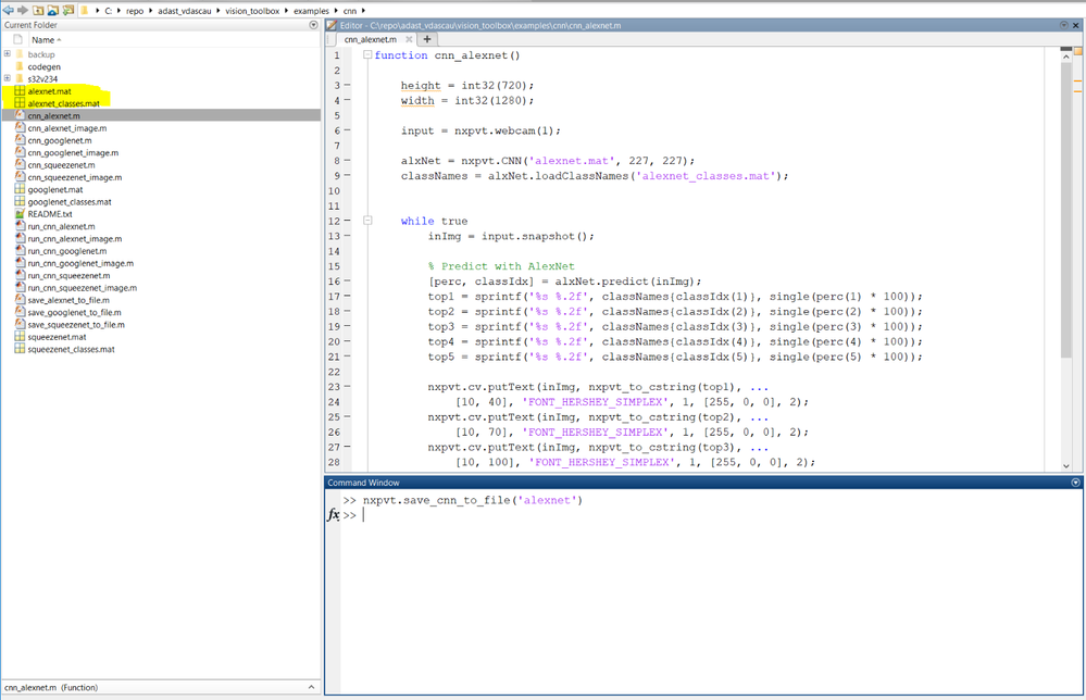

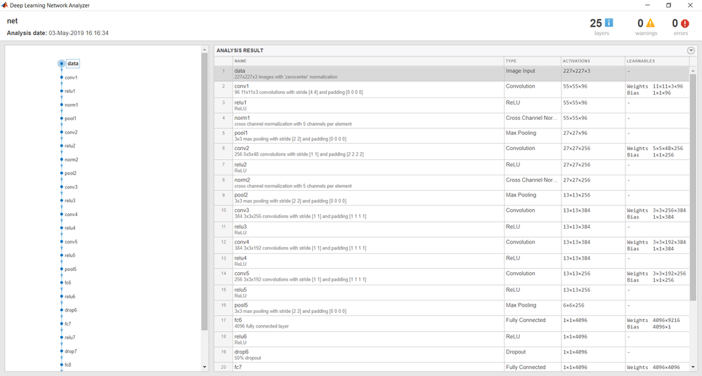

The image input size for this network in MATLAB is 227x227x3. Creating a MATLAB provided alexnet SeriesNetwork object is done with the following command:
To take a peek at the network layers use the analyzeNetwork command as above. This will display the layers with their corresponding weights and biases:
Unlike GoogLeNet, the AlexNet object is of type SeriesNetwork. A series network is one where the layers are arranged one after the other. There is a single input and a single output.

The CNN object is again created with the help of the generated .mat files:

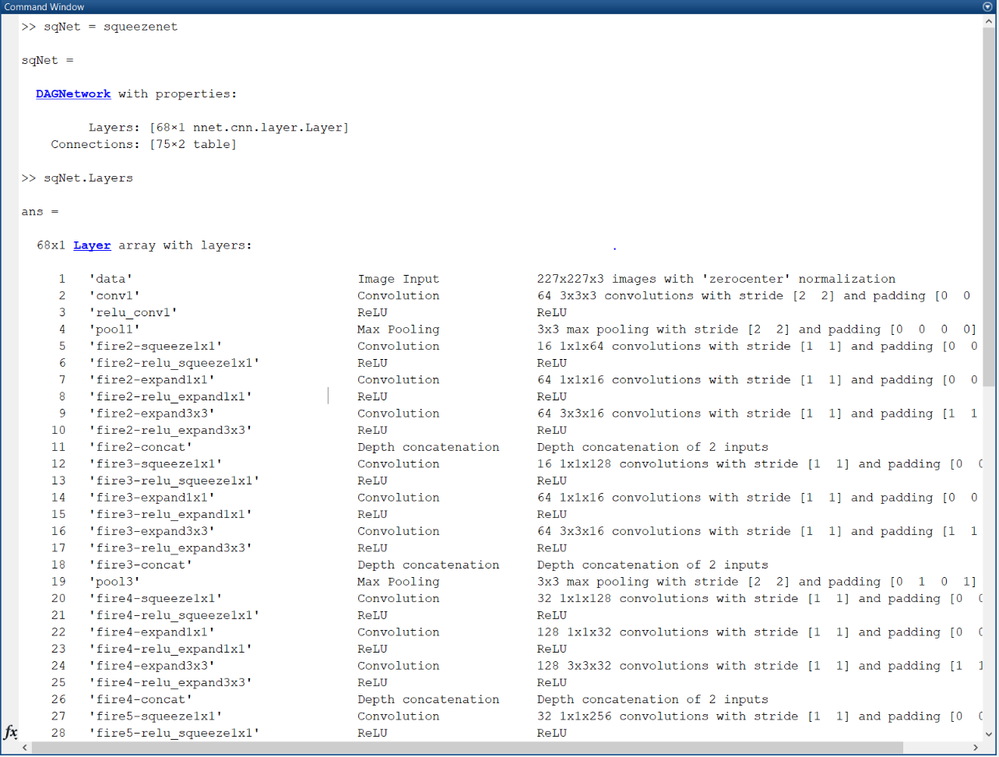

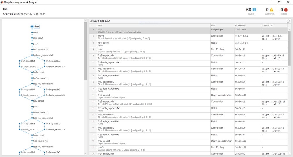

The building brick of SqueezeNet is called a fire module, which contains two layers: a squeeze layer and an expand layer. A SqueezeNet stacks a bunch of fire modules and a few pooling layers. The squeeze layer and expand layer keep the same feature map size, while the former reduces the depth to a smaller number and the latter increases it. The MATLAB implementation is a DAGNetwork, just as GoogLeNet.

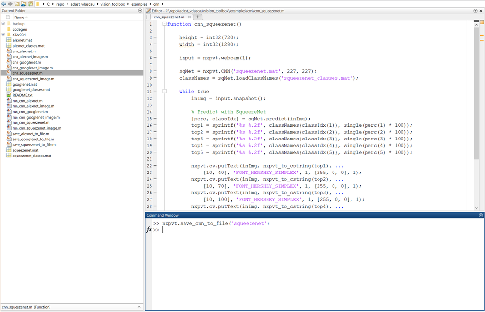

Using analyzeNetwork on a squeezenet object will describe its contents:
The NXP Vision Toolbox CNN object over squeezenet is created using the .mat filse generated with the nxpvt.save_cnn_to_file command.
