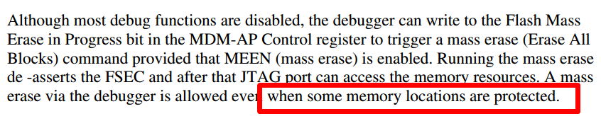

hello,
    <1>  is the following protected in the red box write protection?

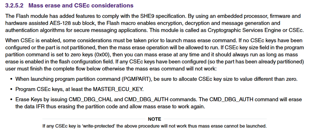

    <2>  if partition has CSE key sapce but no save any CSE key, then enable security, debugger also  can not remove security??

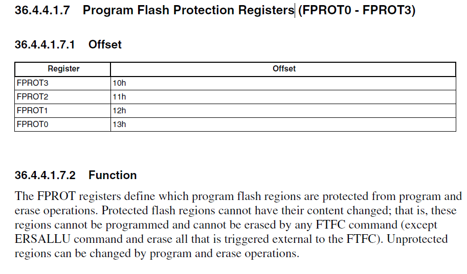

Hello Kui Wu,
1. This refers to the Flash protection, please see below the description of Program Flash Protection Registers.
2. Yes, in this case, it is not possible to mass erase the MCU.
AN12130 Production Flash Programming Best Practices for S32K1xx MCUs

Hello Kui Wu,
