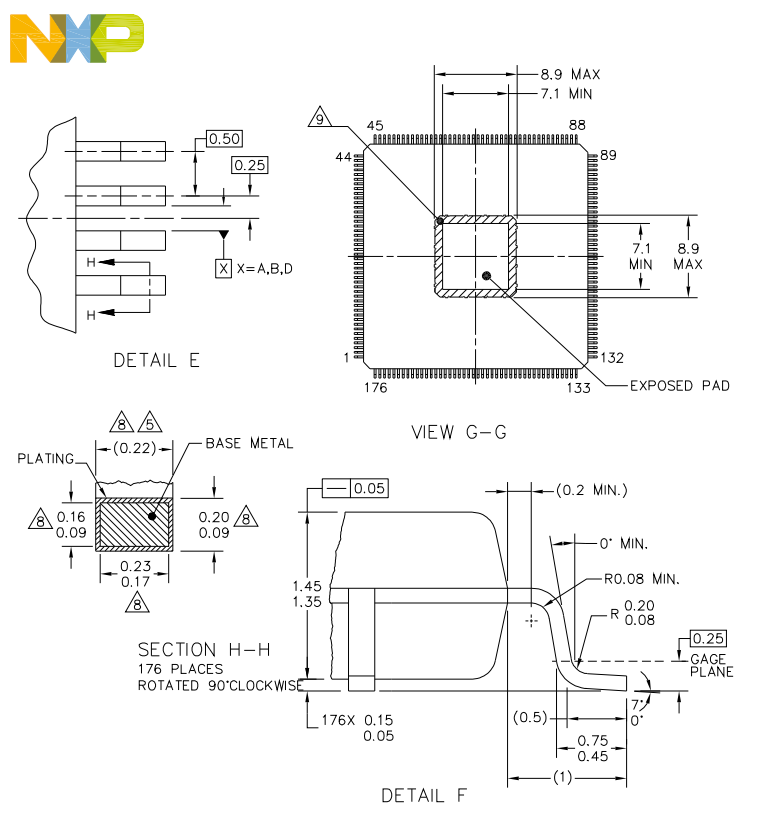

Hellow,
About MPC5748G Component packaging ,I Check the datasheet ,but have a problem ,about 177pin EX_PAD.
I'm using altium designer and don't know how to make this package?
I don't know if there are any pictures about layout, to tell me how to deal with 177pin [email protected]
thank you .
