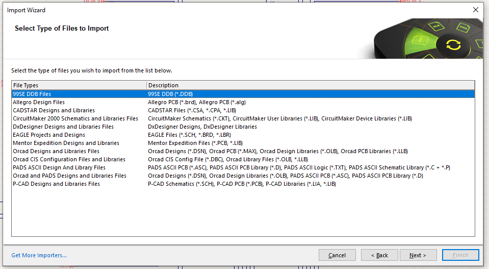

I'll develop a board that will be a shield for DEVKIT-MPC5748.
Then I need the layout file of the devkit in a format that altium opens. Altium just opens allegro format if allegro is installed on the pc but allegro isn't free.
Altium can open different types of files according image below:
Is it possible to send the layout file in a different format than allegro?
The main information I need is the distances between the center of holes that are indicated in the figure below.
This distances need to be very precise because as I'll do a shield for this board if the connectors doesn't match I won't be able to connect the boards.

The package shared above contains also *.brd file. Cadence provides free viewer:
Allegro Downloads
It can be used to measure all required dimensions.
We do not provide the files in other formats.
Lukas

Hi Lukas,
It's really helpful!
Thanks very much!
