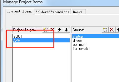

  I use LPC54606 in design like below:
0x0 -- 0x7FFF                  0x8000-...
  boot code            -----     app code
How to jump from "boot code" to "app code" ?
My code is reference from LPC17xxx, but faild!

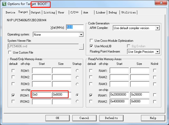

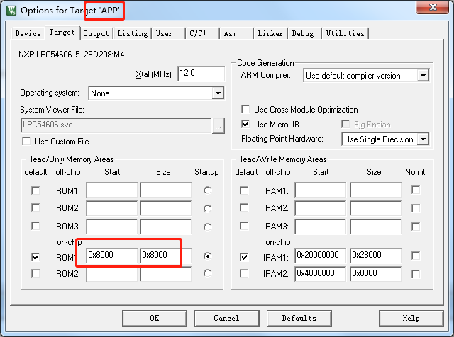

here is my config:
5,873 Views
tinglee

tinglee
Thank you!
Compare to the example, I find the problem:
      in APP sector code, before full init, can't enable interrupt. otherwise will cast to crash!
