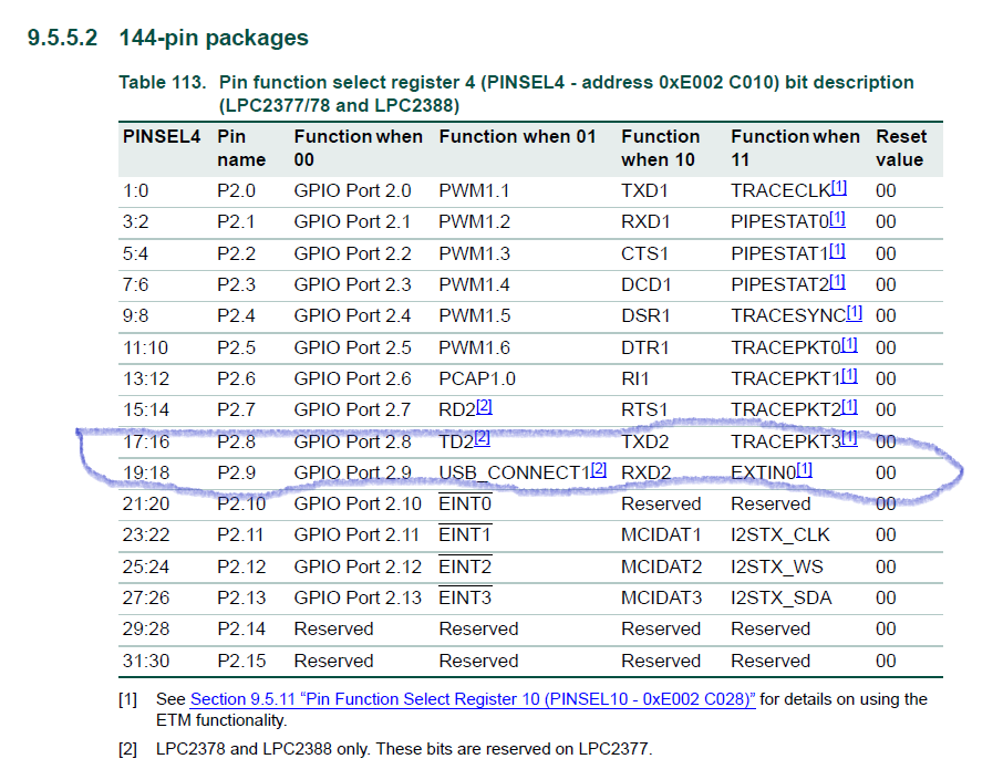

Hi all,
I am looking to get UART2 working on the LPC2388 microcontroller.
Currently, UART0 and UART1 works on it as they are provided in the sample code bundle (using uVision -- the first link under Embedded Software):
Arm7™ with 512 kB flash, 98 kB SRAM, Ethernet, USB 2.0 Device/Host/OTG, CAN, and 10-bit ADC | NXP
After going through the datasheet and user's manual (also given by the link above under the Documentation tab), I made some additions to include UART2 functionality. I can provide snippets of code upon request, but in short, here are the additions I made to start:
  • I am enabling UART2 within the PCONP register (PCONP |= 0x01000000)
  • I am enabling TXD2 and RXD2 within the PINSEL0 register (PINSEL0 |= 0x00500000)
  • I am installing the interrupt handler using UART2's number (it's #defined as 28 in the header file given by NXP)
  • The way I am initializing UART2 is the same way the sample code is initializing UART0 and UART1, with the exception of the registers (it's U2***, instead of U1*** and U0***).
  • The way I am creating UART2's handler is the same way the sample code is creating the handlers for UART0 and UART1 (once again, with the exception of the registers)
  • The way I am sending out UART2's data is the same way the sample code is sending out the data for UART0 and UART1 ("")
Here some other notes that may/may not help:
  • Same baud rates and frequencies are being used
  • I have confirmed that data is going into U2THR register (well, sort of.)
  • The code seems like it is sending out the data, but I am not receiving it on the other side (RealTerm)
    • I see data coming out for UART0 and UART1, but nothing for UART2
  • Code is not being blocked anywhere
I did not see anything unique to UART2 in the user's manual that was not apparent in UART0 and UART1 other than the fact that it is off by default. I know that using an oscilloscope is one of the next options, but I want to rule out everything software related before it comes to that point.
Any insight on this is greatly appreciated.

Hi, Dan,
If you route the uart2 pins to P2.8/P2.9, what is the result?
BTW, can you enter uart2 transmitter ISR? can you see the signal of uart2 TXD via scope?

XiangJun,
Switching to P2.8 and P2.9 for the pins worked! The issue was actually on my side as I just misread a schematic. I did not notice the 2nd pair of TXD2/RXD2. I can also see that the code is going into the transmitter ISR. All verified with a scope. Thank you!
