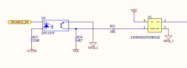

RC_Argo
Awesome, thank you for the response - my problem actually ended up being with the I2C bus which is now sorted.  Now that I have that fixed though, I am unsure how to supply the required 32MHz clock (or standalone crystal as I'm only using one module).  I have 32 MHz crystal oscillators but the interface document is very scarce on how this should be input to the RFEM. What was your solution for that?
6,923件の閲覧回数
ganesh3
Hey Bud! see the picture for details on my setup for the crystal. I used an enable line to control this crystal oscillator (it is optional)
