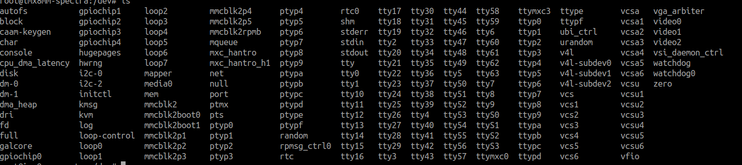

  • I am running linux Yocto kirkstone and the drivers are not loaded a boot and they are:
root@imx8mm:/lib/modules/5.15.60-imx8mm/kernel/drivers/rpmsg# ll
total 56

  • dev folder has no /ttyR* device
  • Though the sys/class/remoteproc/remoteproc0 has quite few files

  • From the point LINUX->M4 everything looks okay in the sys but there is no /dev/ driver.
    Any ideas what is wrong.
