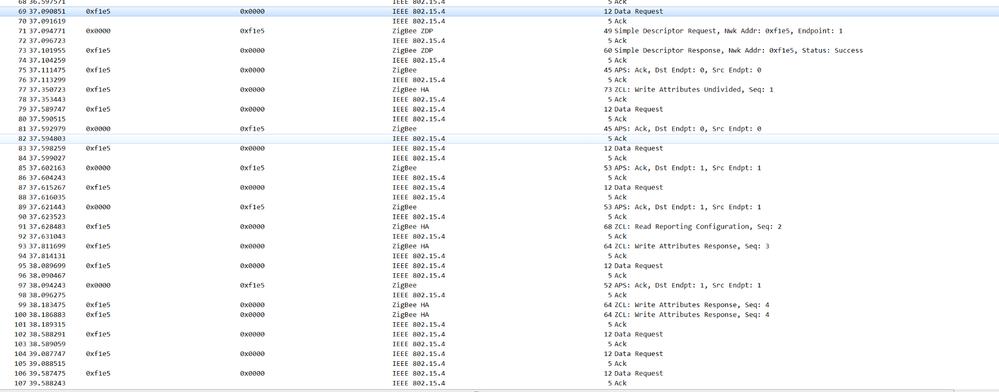

Hello:
         When I used ZPS_eAplAfUnicastAckDataReq () to get the APS:ACK, now I need to add some DATA, to the ACK of this reply, but I can't find where he constructed it, hoping to get some more information about the application layer ACK. Where did he construct it?

Thank you for your reply,I need to dock this device now, I don't have the relevant code, this device is the earlier version of the zigbee protocol before zigbee ha. When they communicate with their coordinator, they put data in aps:ack. I don't know why. But if I want to add this device to our gateway, I need to reply to the message in the same way.

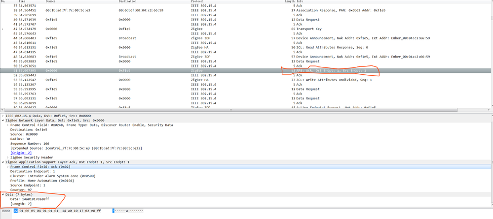

I uploaded two files, one is to join the network successful file, one is to join the network failed file.
This success means that the device joins the coordinator of their own company, and the failure means that the device
we need to dock adds to our coordinator JN-AN-1216.
When join the network is successfully, you can see the APS:ACK contain data by the coordinator send,When join the
network failure,the APS:ACK not carry data by the coordinator send. The End device that do not receive this data will
soon leave the network and try again join the network .So we wanted to know how to add data to the APS:ACK to try
and successfully add this particular End device.

I've solved the problem now.
I  make a general guess of the data inside, and then set the corresponding cluster under the properties, now can work properly, thank

    I'm sorry. I just got back to you right now.
    I need to dock a zigbee device, but this device will retry to join again when it joins nxp JN-1216 coordinator. I found out by a packet capture when adding their original coordinator at APS:ACK  The data will be sent in the frame, so it is considered that the device may take this data to judge. So I want to try to reply to the same data in aps: ack, can join JN-1216

mario_castaneda
Why is the reason that you want to add more data un this specific packet?
As you know, the ACK APS is confirmed that you received the Cluster Command. I recommend looking at the ZPS_EVENT_APS_DATA_ACK event and you could trigger another ZCL command without modifying the ACK.
