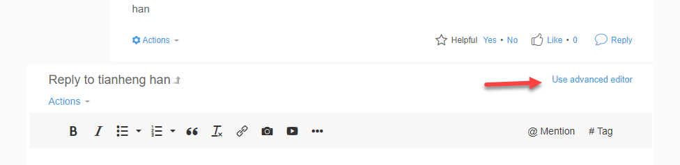

You could attached files selecting the Use Advanced Editor, there is an option for attaching files.

The files are not attached.
Please select the option Use Advanced Editor
You will find the attach option for uploading the files.
