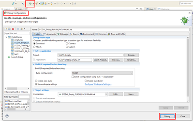

I recently received a new Devkit ZVL128, but when trying to flash it using CodeWarrior, the following error appear :
"an invalid preference was passed to the GDI protocol plugin(HC/RS/S12Z GDI Protocol Adapter) Error: command failed " (See attached file)
I also tried to enter debug mode on a example project and I got stuck in an endless loop. (See attached file)
Any clues ?

Problem solved : I ordered a ZVL32 instead of a 128.

At first, could you please, try to create a new project for S12ZVL128 and try to load the project into MCU using debug configuration option?
Which PE micro multilink do you use?

As mentionned above, If I try to enter debug mode, Code Warrior gets stuck in an endless loop, even with a new project ( Verifying object file CRC-16 to device ranges ...
INF: block 00FE0000-00FE0120 ...)
I tried to flash/debug with the onboard debugger and with an external PE multilink debugger, same issue occurs.
