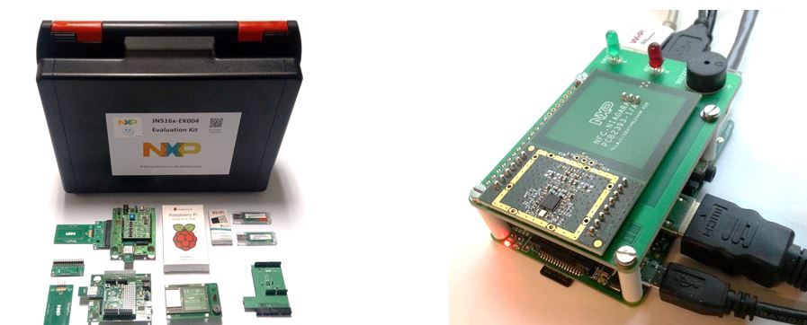

JN516x-EK004 ZigBee Smart Home Kit with NFC Commissioning
  • All necessary hardware components to demonstrate, evaluate and develop ZigBee wireless network solutions with IoT connectivity and NFC commissioning
  • Firmware pre-loaded with demonstration software for both ZigBee nodes and IoT Gateway
  • Free support resources for developing ZigBee applications for the JN516x microcontrollers
  • Expandable with the addition of extra ZigBee nodes, available separately
       JN516x-EK004 Evaluation Kit                               NFC Controller on Raspberry Pi Board
Physical Components
The JN516x-EK004 ZigBee Smart Home Evaluation Kit includes the following hardware components:
Gateway Component
  • Raspberry Pi single-board computer to act as IoT Gateway Host
  • JN5169 USB dongle (OM15020) to act as ZigBee Control Bridge
  • Wi-Pi Raspberry Pi dongle for Wi-Fi connectivity
  • NFC controller (PN7120) for NFC commissioning of ZigBee nodes
ZigBee Node Components
  • Carrier boards (OM15022) to accommodate expansion board and ZigBee JN5169 module, and incorporating NFC connected tag (NTAG I2C) including NFC antenna
  • ZigBee modules (JN5169-001-T00/T01) providing processing platform and RF interface
  • Generic expansion board (DR1199) with switch and level control functionality
  • Lighting/Sensor expansion board (DR1175) with white light, colour light and sensor functionality
