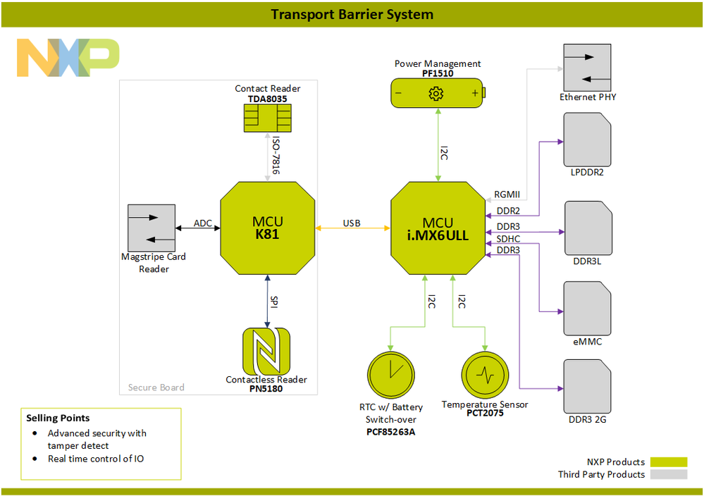

Description
From machine to control access, transport barrier systems can validate tickets and also take contactless payment from credit cards and mobile phones (requiring PCI-PTS 4.0 certification). These systems maintain a database of all transactions including a local copy kept in the machine and a copy uploaded to a central database.
The Kinetis K8x MCU family extends the Kinetis MCU portfolio with advanced security capabilities while maintaining a high level of compatibility with previous Kinetis MCU devices.
The i.MX 6 series of applications processors offers a feature- and performance-scalable multicore platform that includes single-, dual-, and quad-core families based on the Cortex architecture, including Cortex-A9, combined Cortex-A9 + Cortex-M4, and Cortex-A7 based solutions.
Features
  • Control access
  • Validate tickets
  • Database of all transactions
  • EMVSIM module with ISO7816 smart card support
  • Tamper detect module
  • Security Block: TRNG, Crypto Engine (AES with DPA, TDES/SHA/RSA), Secure Boot
  • Includes NXP ISO/IEC14443-A and Innovatron ISO/IEC14443-B
  • Full compliancy with all standards relevant to NFC, contactless operation and EMVCo
Block Diagram

Category Name 1:
MCU
Product URL 1
Arm® Cortex®-M4|Kinetis K81 150 MHz 32-bit MCUs | NXP
Product Description 1
The Kinetis® K81 MCU extends the Kinetis MCU portfolio with advanced security capabilities including anti-tamper peripheral, boot ROM to support encrypted firmware updates, automatic decryption from external serial flash memory, AES acceleration, and hardware support for public key cryptography.
Product URL 2
i.MX 6ULL Applications Processor | Single Arm® Cortex®-A7 @ 900 MHz | NXP
Product Description 2
The i.MX 6ULL provides various memory interfaces, including 16-bit LPDDR2, DDR3, DDR3L, raw and managed NAND flash, NOR flash, eMMC, Quad SPI and a wide range of other interfaces for connecting peripherals such as WLAN, Bluetooth®, GPS, displays and camera sensors.
Category Name 2:
Readers
Product URL 1
High integrated and low power smart card interface | NXP
The TDA8035 is the cost efficient successor of the established integrated contact smart card reader IC TDA8024. It offers a high level of security for the card by performing current limitation, short-circuit detection, ESD protection as well as supply supervision.
Product URL 2
PN5180 | Full NFC Forum-compliant frontend IC | NXP
The PN5180 is a high-performance full NFC Forum-compliant frontend IC for various contactless communication methods and protocols.
Category Name 3:
Power Management
Product URL 1
PF1510 | PMIC for low power application processors | NXP
The PF1510 is a Power Management Integrated Circuit (PMIC) designed specifically for use with i.MX processors on low-power portable, smart wearable and Internet-of-Things (IoT) applications.
Category Name 4:
Peripherals
Product URL 1
PCT2075: I2C-bus Fm+, 1 Degree C Accuracy | NXP
The PCT2075 is a temperature-to-digital converter featuring ±1 °C accuracy over ‑25 °C to +100 °C range.
Product URL 2
 PCF85263A | NXP
The PCF85263A is a CMOS Real-Time Clock (RTC) and calendar optimized for low power consumption and with automatic switching to battery on main power loss.
