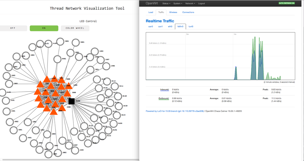

This demo showcases an OpenWRT based Thread Border router running on i.MX6UL and the various options to configure and use routing, firewall and out of band commissioning for Thread networks in combination with WiFi, Ethernet and NFC. OpenWRT is an open source Linux distribution for embedded devices specifically designed for residential gateways and routers. When enhanced with the Kinetis Thread protocol it offers the perfect solutions for creating a Linux based Thread Border Router

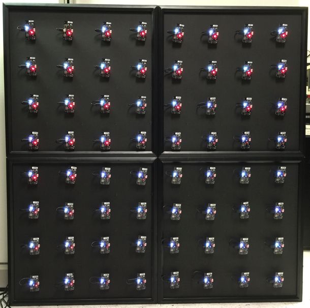

Large and dense mesh network consisting in 64+ Thread nodes
Each node is router capable, network decides dynamically which nodes become active routers
Multiple application functionality run in parallel:

  • Border Router with Network management web GUI

  • Network management and interoperable Thread diagnostics framework used to monitor node state
