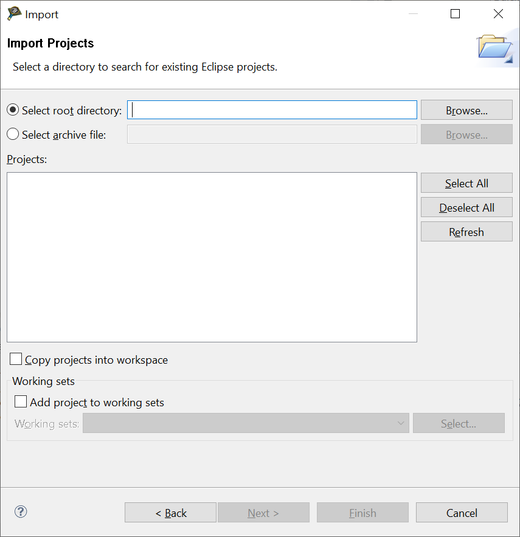

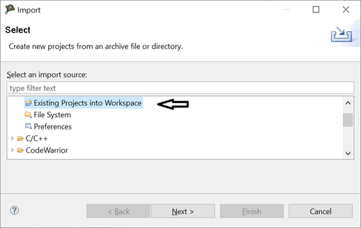

1. Download the attached file2. Unzip it
3. Upload it to CodeWarrior

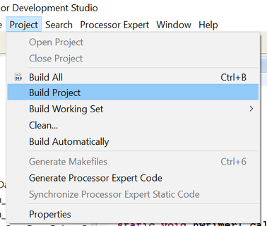

4. Compile it

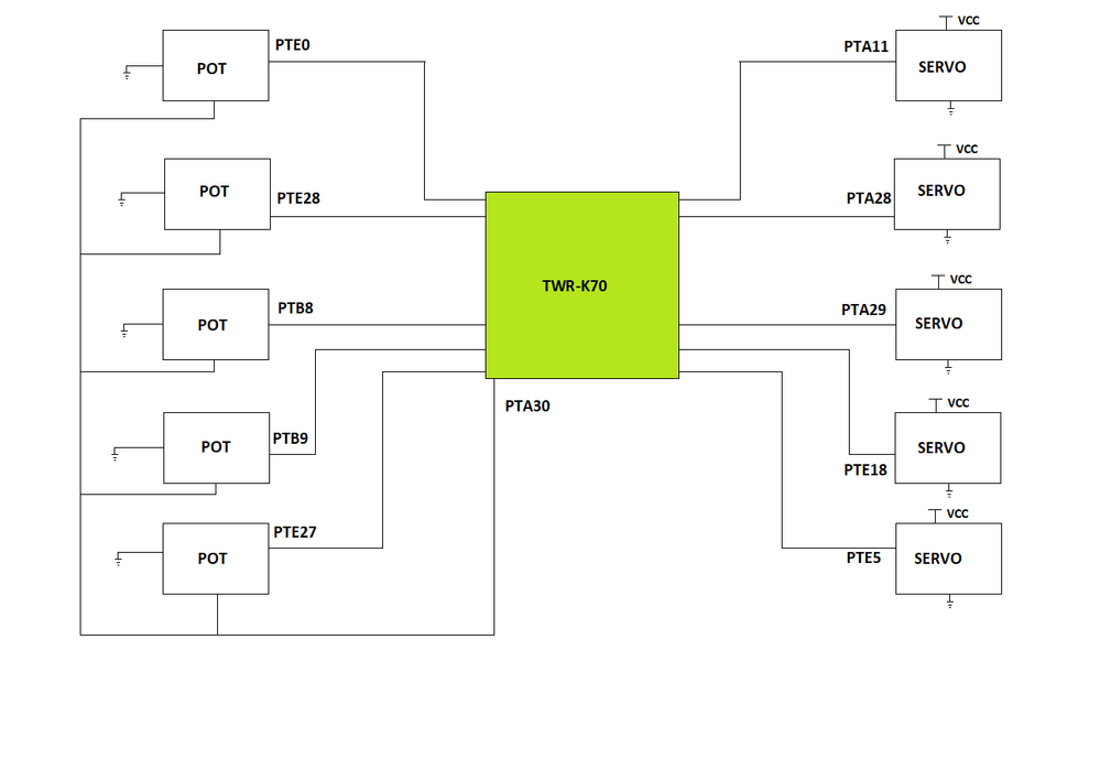

6. Make the connections in the diagram
7. Connect to Power Supply
8. The variation in the potentiometers will vary the position of each motor
