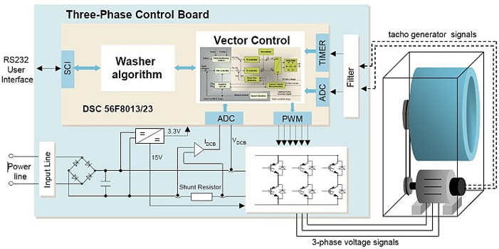

This reference design is based on 32-bit DSC MC56F82748, to demo a BPM Sensorless FOC Washing Machine. This reference design jump-starts your ability to leverage the NXP® DSCs' advanced feature sets via complete software, tools and hardware platform.
  • Three-Phase BPM/PMASR drive with sensorless FOC
  • IEC60730 certified controller
  • Speed range 200RPM – 18000RPM (motor speed), 20RPM – 1600RPM (drum speed)
  • Position and speed detection using extended Flux observer and DQ Back-EMF observer and tracking observer
  • Non-recuperative braking and deceleration control
  • Ultra low speed operation with rated torque, and ultra high speed operation with advanced field-weakening algorithm
  • Over-current, over-temperature, over-voltage and under-voltage protection
  • Serial RS232 control interface
  • FreeMASTER GUI for easy debugging
Features
  • MC56F82748
  • BPM Sensorless FOC Washing Machine
  • HVP-MC3PH
  • HVP-56F82748
Block Diagram
